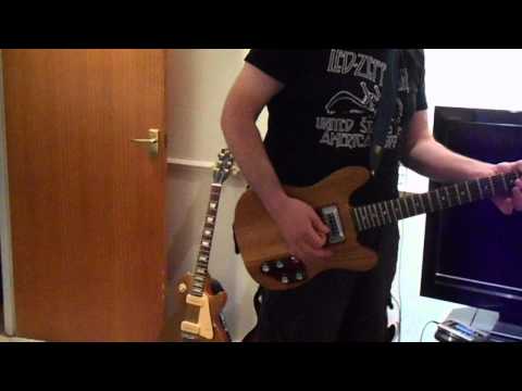

    Ohh I don't know...  Ive made a couple of guitars from Oak...  One glued neck, one was a neck through and ive done one guitar with a solid maple body and an oak neck.
    Id say as long as you get the weight right by say making a smaller or thinner body guitar the weight is ok.. I wouldn't make a fat LP type guitar with it. Flat top slab guitar, yes.
    I will also say that my only big issue with oak is it does eat your tools up...
    But id say it can be done for sure.  And for a neck, its a great material.. The maple /oak guitar I made with the oak neck hasn't moved a tiny bit since it was made.
    Id post pictures but Imgur isn't working properly at the moment. One of the bodies was made with some spare kitchen top surface I found at my sisters house and I actually really liked how that came out :)
    I do have a vid of the neckthrough I made (my second ever guitar) but you will have to put up with my crappy playing..
  • Cheers, @Rabs, but it also depends on what he wants to do with it. I'll see what he comes back with.

    @Rabs - at about 40 seconds you start hitting a D, and all day it's been bugging me what it puts me in mind of. Anyway, got there in the end... Knopfler doing Expresso Love from the album Making Movies. Not doing too well at this embedding videos lark...
    https://www.youtube.com/watch?v=etnB1h8hFb8&feature=share
