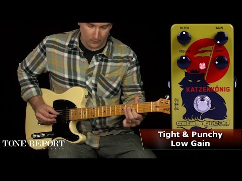

The Catalinbread Katzenkonig
Sounds awesome, but does it have a Fuzz Circuit or just a normal Distortion Circuit?
Any more Fuzzy Non-Fuzz pedals you know of and can recommend?

    I've been interested in that one for a while too! I believe it's a tonebender circuit into a rat circuit. So it should sound awesome. It does seem to sound like a Rat in the clips, but fuzzier thanks to the input gain control. Could be just what you're after if you're like me and wish the Rat had a bit more of a fuzz quality at lower distortion settings.
    Fuzz dogs does a clone kit for about £50 with enclosure if you fancy a DIY - I'm tempted!

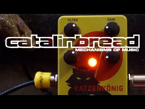

    The Katzenonig is a Tonebender/Rat hybrid circuit.   It has a pre gain control which may help it play better with impedence issues.
