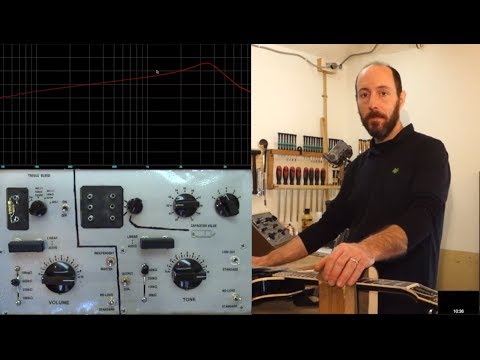

    As stated above, lower value pots (both volume and tone) will take off some high end. This is a good video explaining what you would expect from putting in new pots ...
    It looks more like a photo to me
    Sorry, the link broke when I edited the post.
    Fixed now. :)
