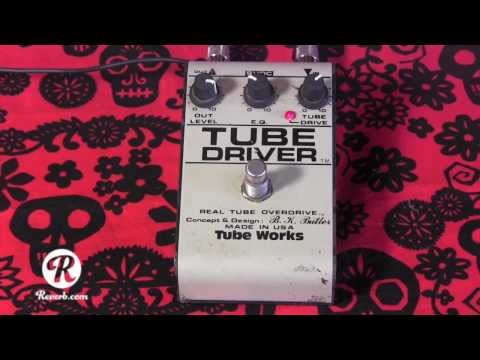

    I had a feeling that it might be a Boogie thing, and also the way it interacts with his "Valve Driver" too for some sounds.  I have never played a Boogie, so it is good to get some confirmation that this sound is part of their signature.  I also have to agree with @dindude about the quality of his cleans and verge-of-breakup tones, excellent.
