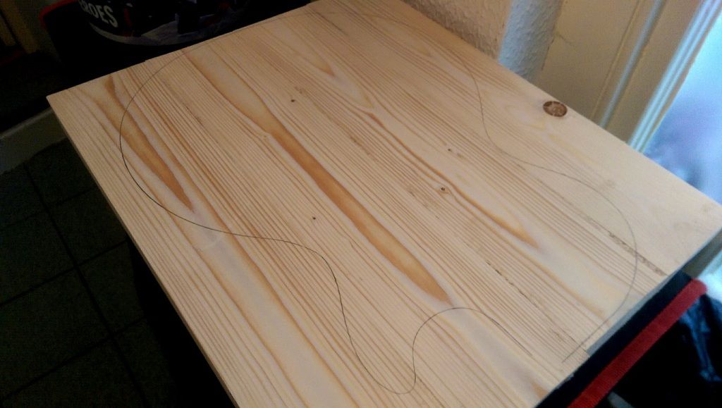

Got the routing done on the body and the body basically cut to size. Still lots of sanding to do and some filling where I had a little bit of tear-out with the router.

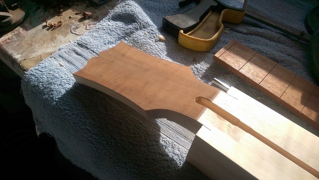

This shows the ash block that I'm inserting into the body to take the bridge posts.

It's not the easiest to rout because although the router cuts it really easily, it can tear chunks out in places. But then because it's a soft wood it's very easy to sand, etc. It's definitely different to using a hard wood!

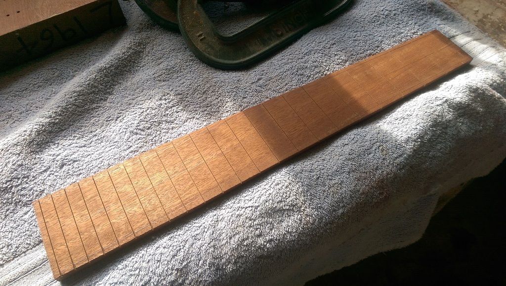

Testing the neck joint with no glue or anything - nice tight fit!
http://i1135.photobucket.com/albums/m622/Serratus1/IMAG2509_1_zpsgkmpxbac.jpg

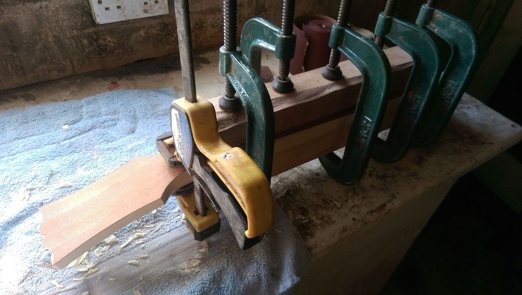

Gluing the neck on!
http://i1135.photobucket.com/albums/m622/Serratus1/IMAG2518_1_zpssrn4pxsv.jpg

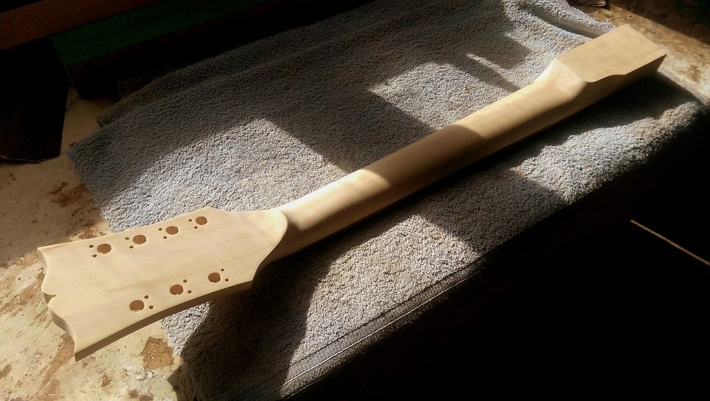

Neck glued on:
http://i1135.photobucket.com/albums/m622/Serratus1/IMAG2528_1_1_zpsffdhhgwu.jpg

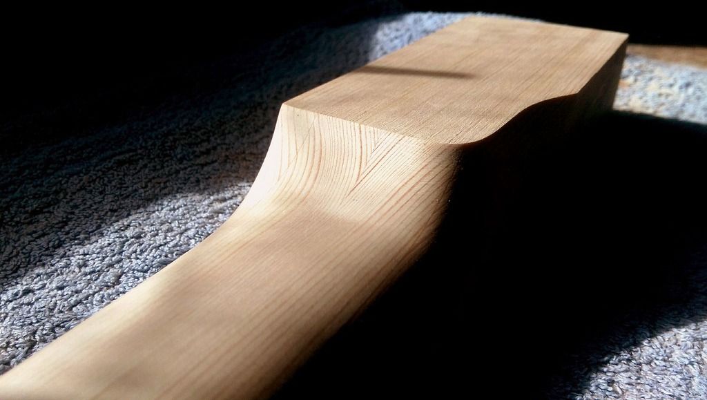

Routed the front of the neck level with the body front:
http://i1135.photobucket.com/albums/m622/Serratus1/IMAG2558_1_zpse0wrflcg.jpg
Should make a comfy neck joint, still needs cleaning up yet:
http://i1135.photobucket.com/albums/m622/Serratus1/IMAG2563_1_1_zpswendrov6.jpg

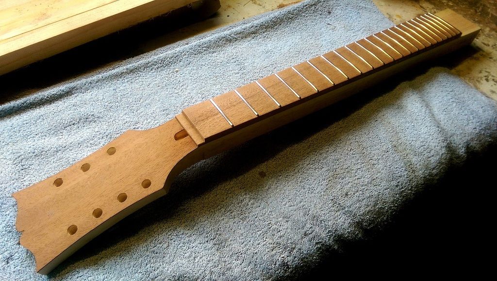

Oiled the neck and board:
http://i1135.photobucket.com/albums/m622/Serratus1/IMAG2601_1_zpsudyayhfo.jpg

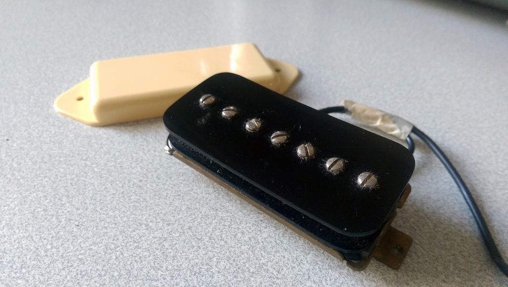

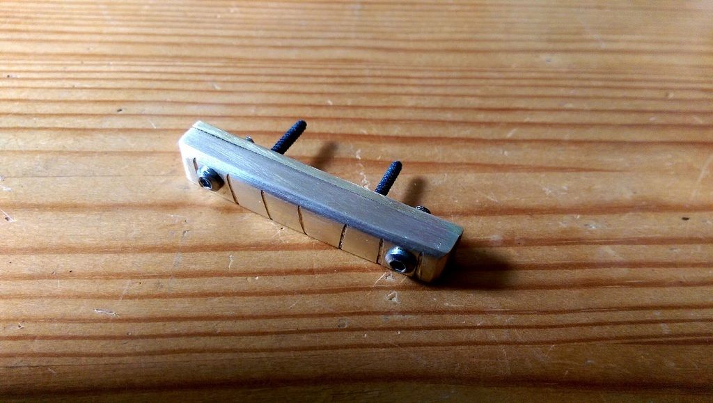

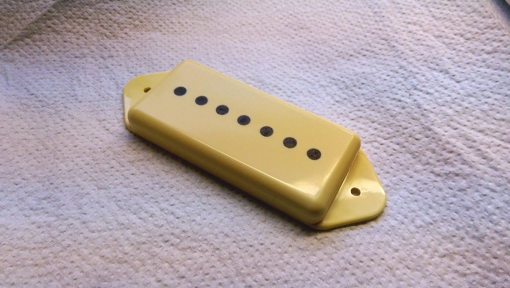

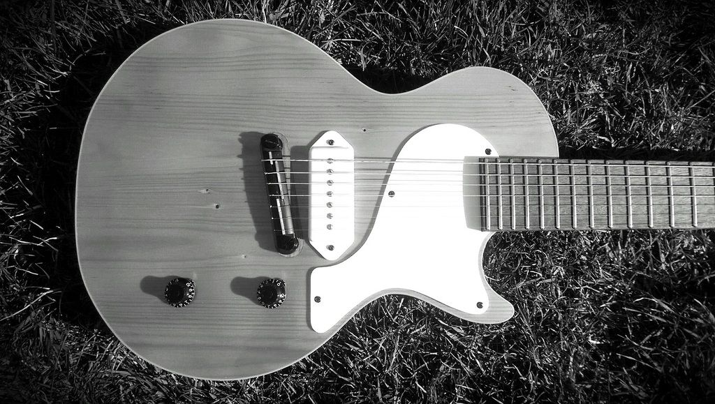

So I found some old pickup pole piece screws at the bottom of my parts box, so I redid the pickup cover with the tops of the screws glued in place - looks pretty authentic I think!! (for those who didn't read the first page, the 7-string P90 I made had to be glued together, so the pole pieces aren't adjustable. So it'll just sit underneath this cover)
http://i1135.photobucket.com/albums/m622/Serratus1/IMAG2688_zpsdx6snmvy.jpg

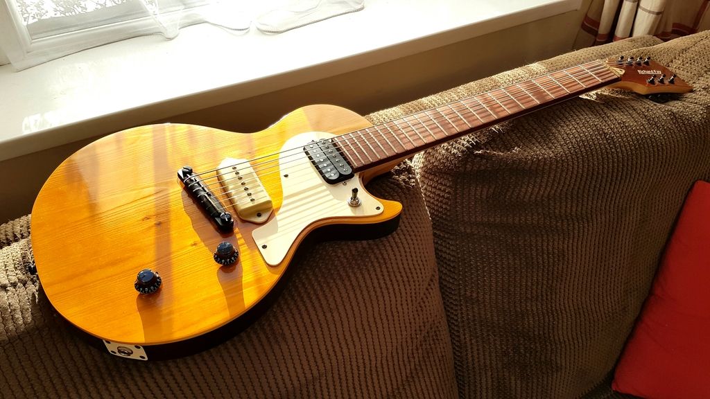

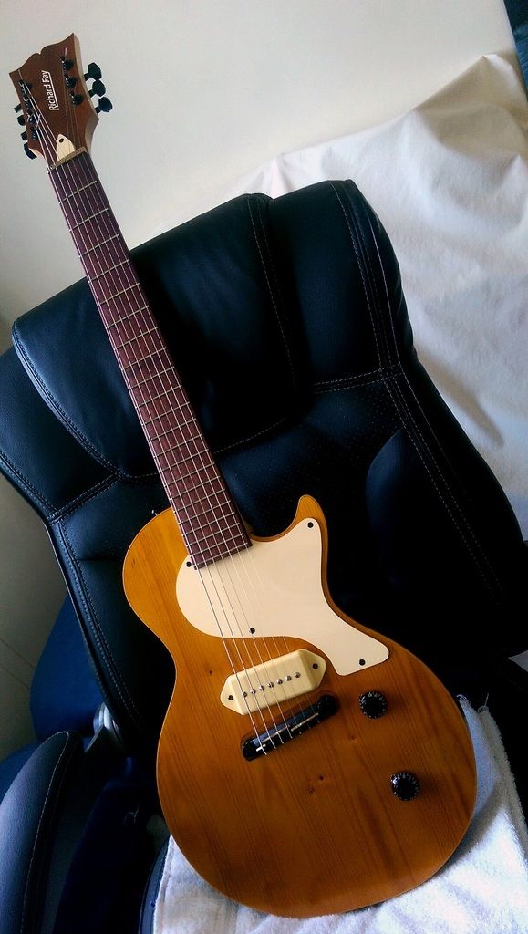

Getting there!

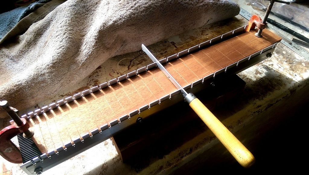

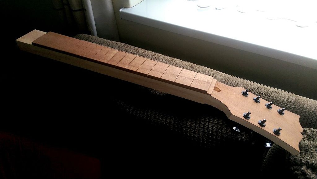

I've still got to polish the body, but today I levelled the frets and did a few little jobs like checking the plates still fitted okay after lacquering, etc. Couldn't resist putting the scratchplate and pickup cover on to take a quick picture
http://i1135.photobucket.com/albums/m622/Serratus1/IMAG2706_zpsbd8qajue.jpg
