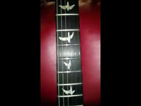

    Three videos detailing the differences between pickup positions using clean and crunch settings.
    Also includes (covered) 59/09 and 85/15 comparisons. I wont re-post these in other threads but shall link to this post instead.
