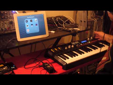

    I doubt it will work. You need to buy something like this:
    https://www.thomann.de/gb/maudio_midisport_uno.htm
    Check the video I posted above.
