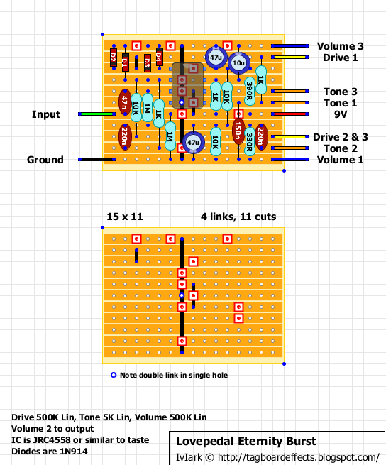

    I also got started on my first Vero build.  I've cut the board to size, done the links (carefully) and got the resistors on.  It's a Lovepedal Eternity Burst clone:
    I bought this as a kit from bits box so that I didn't have to faff hunting the correct components at the outset.  It says the diodes should be 1N914, but the ones that were supplied were 1N4148.  From what I've read, these should be interchangeable and have no issues?
  • Adam_MDAdam_MD Frets: 3420
    1n914 and 1n4148 are essentially the same thing Steve.  I actually prefer the regular eternity the ‘burst’ version has a little too much gain for me.  It’s worth building both of them imo to see which you prefer.
