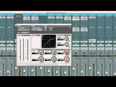

    Drew_TNBD said:
    I usually EQ before and after compression - compression can bring out the highs a bit too much, and too much low-end going into a compressor can make it pump too much. I'll also stack compressors, so instead of having one doing a lot of compression, I'll have two or even three doing little bits here and there.
    When you stack what is your process, is it something like well this individual track needs it peaks tamed a bit as its pokey so you put a bit of compression on that track, then later on in that track's bus you do a little more to affect the whole bus etc or is it multiple compressors on a single track?
    I still find hearing subtle compression tricky sometimes so I think I have a tendency to go for fewer compressors doing more...and prob still ruin it sometimes :)
    Grahame from Recordingrevolution goes into it here:
    @PolarityMan What Drew is doing here is called Serial Compression, i.e putting one effect after the other. So the effect of compression is cumulative, so if you stack a number of compressors at low settings you'll get a more subtly reduced dynamic range, (i.e, 3 compressors set at 2:1 ratio combines to form a 6:1 ratio by the time the audio has got through the last compressor) and the the compressors won't crap out in the same way as if you'd put one compressor on at high settings.
    In answer to your question (not that you asked me, but I am OP ) I use my ears! Sounds obvious, but I don't have a thought process so much as putting stuff where it's needed. I'm very much an engineer before a mixer so I really like to get as much done in the room as possible so that mixing is very simple.
    Some things I do without thinking though is high-pass EQ almost every track except for kick and bass; cutting out the boominess to leave room for the bits that belong there.
    Something else worth noting is that I rarely use compression for it's intended purpose - level/dynamic control - instead I'll use it to create a certain sound or get a bit of mojo. If you've got really cutting peaks (i.e a loud snare hit) the only real way of taming that is with automation.
