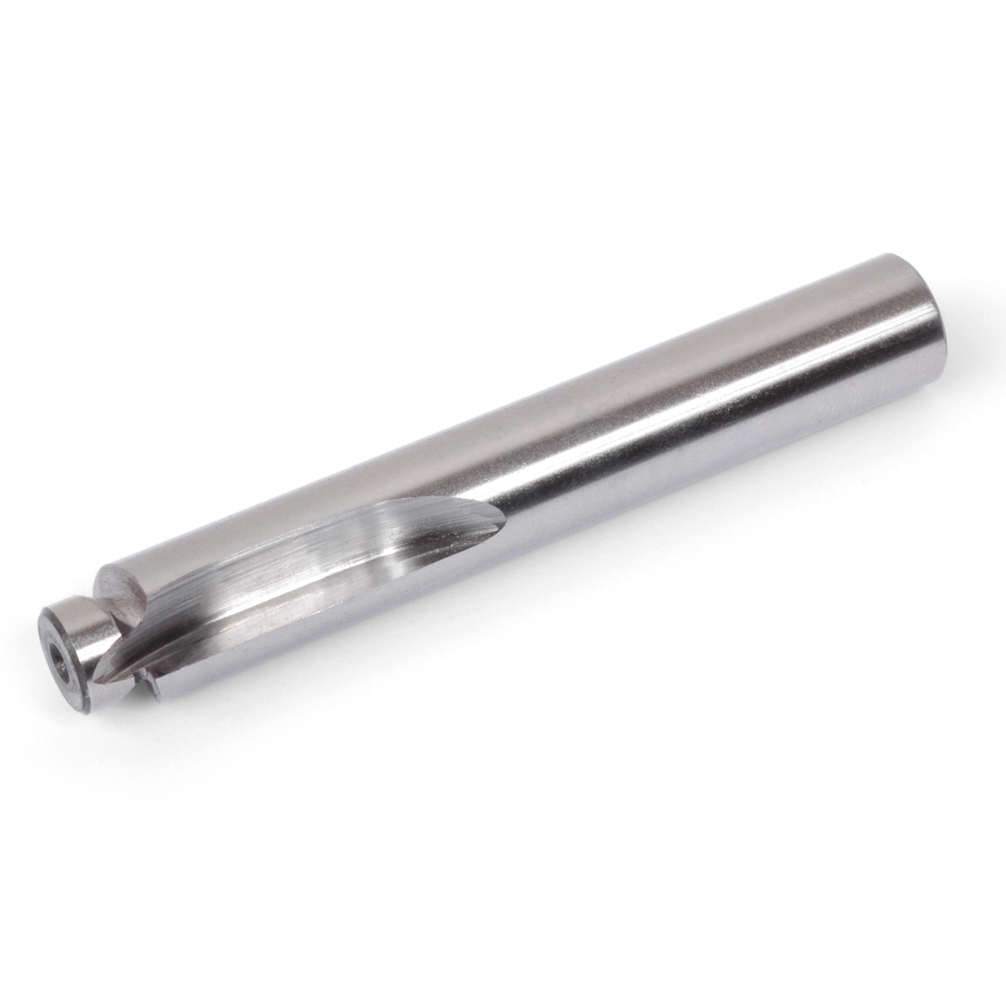

    I would guess that on the front of the headstock the shafts of the tuners are restrained in the centre of the hole by push-in bushings and that the holes drilled through the headstock will be smaller in diameter than that needed to install higher quality sealed diecast bodied tuners.  In this event the best way to bore out the holes to the correct diameter is using a tapered reamer or accurately using a press drill to widen the holes.
    Even better, there's an excellent StewMac tool for this, which is a parallel reamer with a central guide pin which you use from the back of the headstock and which only bores out enough wood for the new tuner body to fit - it self-centres in the old hole and doesn't go right through the head... there is no need, since the threaded collar itself will fit through the old hole. It actually does a better job than boring right through at the full diameter since the smaller hole holds the collar more truly upright when the string tension is on it.
    It's worth the price even for one installation - it takes all the risk and need to use a bench drill out of it, you can easily do it with a hand power drill.
    https://www.stewmac.com/luthier-tools-and-supplies/tools-by-job/tools-for-tuner-installation/rear-peghole-reamer
  • WezVWezV Frets: 17493
    Yeah, thats my most valuable tool from stew mac.  Not the one that cost the most, but the one that saved the most errors.
