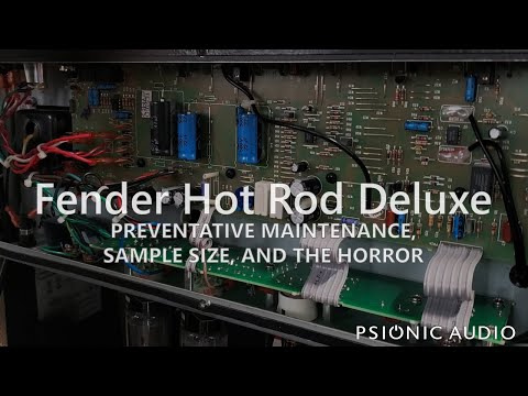

Been watching the Psionic Audio YouTube channel. Interesting yet slightly depressing inasmuch as lots of production amps seem doomed to fail after a relatively short time.
So, what is (more) reliable than something like a Hot Rod or a Katana? Solid state or valve, and not boutique.
Conversely, what's the 'definitely avoid' list?

    Well a Hot Rod is pretty reliable in general. Plus it's not difficult to fix if it does go wrong. In my experience anyway. I haven't seen any Katana's yet.

    I have a pair of HRDs, one is faultless, the other one is stuck on the clean channel, so I'd call that 100% reliable.

    Been gigging a hot rod deluxe mkIV solidly for the last 3 years - and other than the strap handle coming loose from the fitting - it's all been tip top.

    I've gigged HRDs for years... no failures. I call internet BS about them being unreliable - or just a vocal minority. See final line in this reply...
