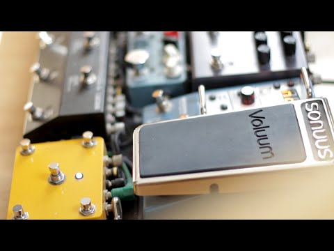

    Sonuus wahoo and voluum pedals can send cc expression messages I think.

    Thanks. Just read the manual and looks like MIdI out is super basic

  • mrkbmrkb Frets: 7257
    TimmyO said:
    Just checked and the Wahoo is only MIDI via USB but Voluum has standard MIDI ports so check what you need..

    yeah I did - it’s very basic and can’t be set to send a particular midi cc

  • english_bobenglish_bob Frets: 5290
    edited January 2023
    TimmyO said:
    mrkb said:
    TimmyO said:
    Yes it can. Mine does. You can select which channel it transmits on, and what CC number. You can even select what CC values the toe and heel down positions are.
    (EDIT: just checked and this information is *not* in the manual, which isn't helpful. It's definitely possible though, but you'll need the PC editor app to set it up. This dude's video shows how to absolutely rinse this very versatile pedal for everything it can do: )

  • ^^^ no worries. It's a very versatile pedal, but it's pricey (which is not to say it isn't also good value for all the stuff you can do with it) and difficult to get the hang of because there's so much in the box and so few controls on the pedal itself. It would be much simpler with a proper screen instead of the three-digit display, but that would mean more complexity and more cost I guess.
    The PC app makes life *much* easier (and lets you access stuff you can't with the pedal itself) but you have to go through all the faff of having it hooked up to a computer when you're writing patches, which isn't ideal for band practices...
    edited February 2023
    I hadn't seen the manual - looks like you can use the toe switch to toggle between two different CC numbers, which is very cool. Being able to add extra footswitches and have them send more CC messages is a nice touch too.
    The only thing I can do with my Sonuus Voluum that this can't is switch between different MIDI channels easily so that I can use it to control different pedals. You can do it on the Boss pedal with the app of course, but who wants to do that at a gig?
