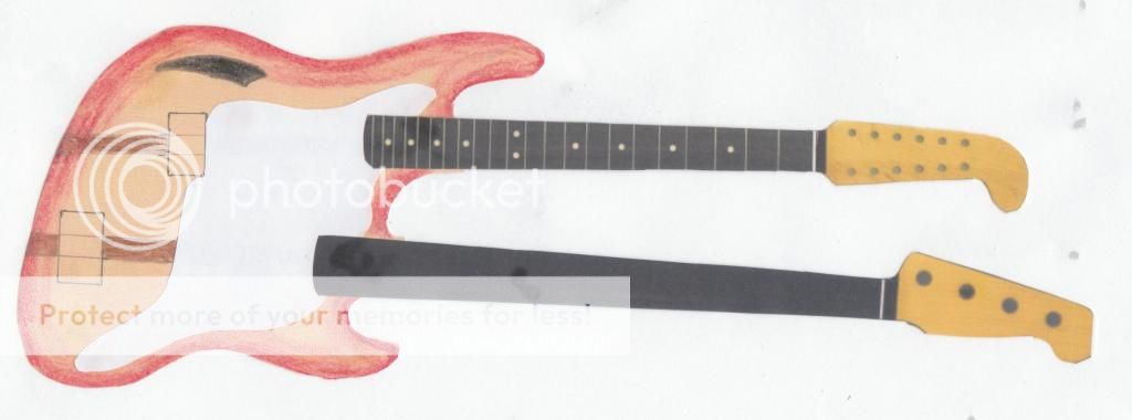

    The more I think about this, the more I want a new body built to my spec - electric xii & jazz in style, 360 in construction.
    I even put together a little mockup, although somewhere the head of the bass got trimmed annoyingly.
    Thinking about making the body myself ... I can wield a jigsaw ok, and just about all the routing will be on the inside ... so maybe I can manage it if I buy myself a router?
    And any tips on where best to source the wood? Maple with strips of walnut preferably.
