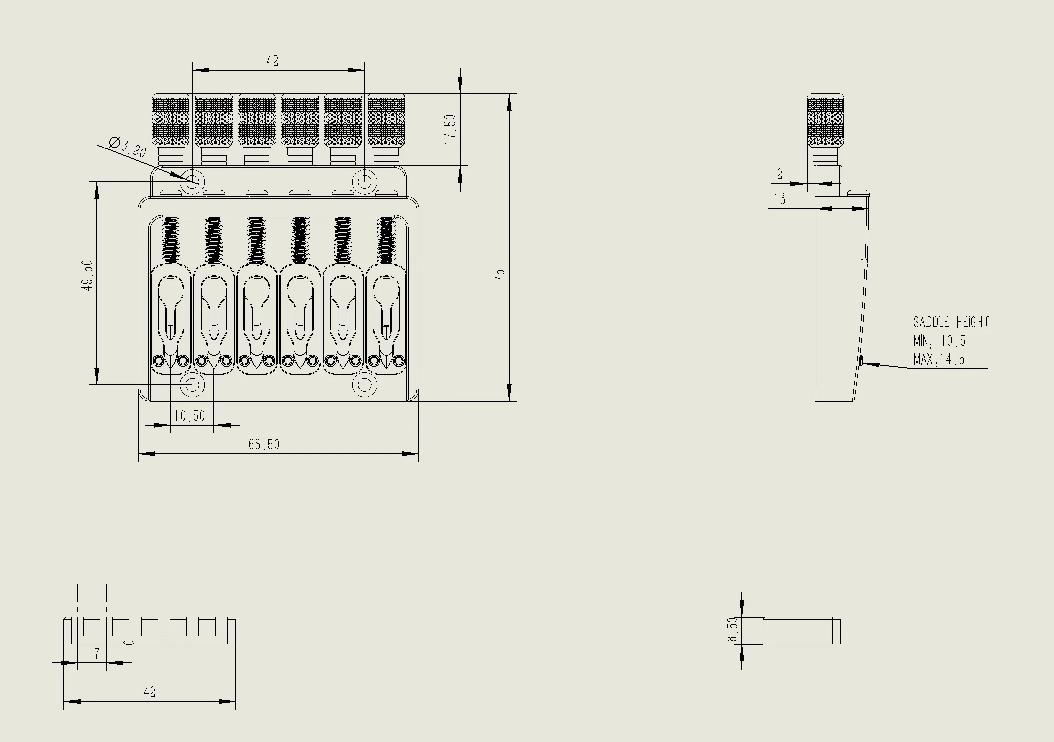

This guitar is another step in my journey towards ”the one”. I’ve spent the last couple of years experimenting with headless guitars, and in particular with headless tuners. The journey started with the truly appalling Overlord, and continued with the somewhat heavy J Custom, and the incredibly expensive Hipshot. This time I’m using the rather intricate Nova system. The project actually started last year, when I bought all the parts. It got delayed, and then stopped completely when I used the neck to replace the warped neck on my previous build. All that remained was a three piece Sycamore neck blank, and that’s my starting point

The body will be Cedar of Lebanon. Last time I used a Yew cap. This time I’m tempted to use a blue veneer which I picked up earlier this year at a wood working show, set off by white binding. The plank wasn’t quite wide enough, so I rough cut the blank, and glued the offcut from the upper waist on to the lower bout.
Every build has a slightly different body shape to accommodate the tuner bridge design. The Nova doesn’t have much room for manoeuvre, both longitudinally and in height. Hence I’ve been drawing directly on the wood.

    Did you go for the vibrato Nova, or the fixed bridge? I used the vibrato unit on my last guitar build and found it didn't correspond with any commonly available templates (i.e. it's different from a Floyd etc), so was a little more difficult to work with than I anticipated. Muddled through though, and it's very good in use - better than the ABM bridges, and smooth to tune with the thrust washers. Only slight issue can be the ball ends getting caught in the adjuster nuts, but they tend to only do so if they're threaded on with the 'less open' end outermost (seems almost tapered - apologies for the poor explanation).

    @marvin It’s a fixed bridge. The body shape will be similar to my previous guitar build, a headless Strat shape. The strap buttons and the bridge will be in the same positions as previously because that’s what I find most convenient to play. This might mean an adjustment to the back end of the body because the Nova tuners are shorter than the Hipshot.
     I’m expecting some careful measurement when I install the bridge, during which I’ll move the controls slightly. There’s also a longer neck because the Hipshot headpiece screws longitudinally into the neck, and the Nova screws go front to back, and need more length and depth beyond the zero fret.
