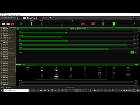

  • you should be able to adjust the upper most value by grabbing it and sliding right if I recall correctly

    Yeah you can drag the white max and min pointers, but the max one is quite well hidden when it's at 100%. Confused me too.
    Alternatively this is an even more user friendly way:

    Easily done - you just assign a footswitch or expression pedal & adjust the top/bottom sliders in PG Edit as per your preferences.

    Found the max slider. it really is well hidden, although I have eyesight issues at the moment too, which doesn't help!
    So here's why I wanted it;
    I've set up a dual delay, one of which is a 100ms slapback, and the other is tap tempo delay with a little more feedback.
    I have the slapback set to 35% mix at maximum and 0% at minimum, and I've set the tap delay to 30% on the minimum slider but 0% on the maximum, effectively reversing the footswitch function from the other, and I've triggered them both with FS7.
    This means that FS7 now toggles between slapback and tap tempo, effectively giving me two different delay pedals in one block.

    Funnily enough I was going to mention the ability to assign multiple parameters (even across different blocks) to the same footswitch, and reverse the max/min. Not that impressive I guess, but not bad for what is a pretty cheap bit of kit second hand these days.
