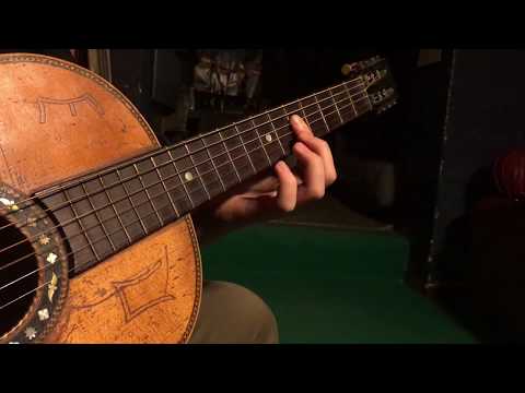

    Here is the closest similar example I have found, slightly fancier decoration but an exact match on the rosette inlays

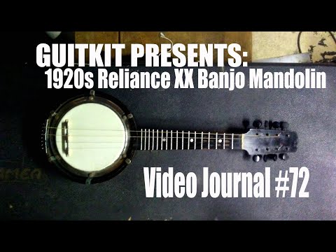

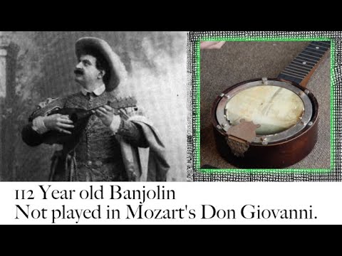

  • At the risk of hijacking your thread (but I think it's sort of relevant to the "dating by fret type" discussion), my banjolin is a lot like these two, which are reckoned to be 1920s or earlier. And they both appear to have tanged frets.
