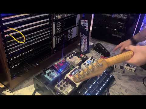

I was messing about with the LVX and the Hexe reVolver IV earlier and talked through the process of creating background texture parts for my band's FB group ( https://www.facebook.com/groups/oddfoxfans if you want to join ).
Foxes are a 5 piece band with a prominent lead instrument (violin) and another guitarist. I have to find ways to compose parts that fit the band aesthetic without getting in the way of the other instruments.
A lot of the time when I see people using looper they are used to create static loops that are overdubbed to layer up parts that someone then sings or solos over.
I never liked that approach, I mean it is fine for others to work that way but it never really appealed to me and esp when playing with other people it can turn into a train wreck if you are 32nd note out with your loop selection.
So creating background, pitch shifted, filtered and bitcrushed textures was something I preferred to do- I got a lot of this from listening to guitarists such as David Torn, Brill Frisell and Robert Fripp and amalgamated their various approaches into something that, hopefully, sounds like me.
Anyyyhoooo... here it is.

    A static loop is a loop that is a sample that repeats over and over, essentially the same.
    My approach to looping is to manipulate the loops in a number of ways after they have been sampled.
    In the example above it goes through an evolving LPF, so it is never the same each time.
    It is more 'organic' and creative IMHO.

    If you don't have reverse and 1/2 speed then you can't access those features, sure.
    But the focus here is is how I construct/build the loops.
    Feeding one loop into another looper is a really good technique, esp if there is some sort of filtering/sound mangling capability in the second looper.

    This is what I do.
    Filters with un-clocked LFO's are the simplest way to do this.
    If you have a 2 second loop and a filter that responds to an LFO so that its sweep is not a multiple of 2seconds then you will have an asymmetrical response because the filter sweep will crest at different points in the loop each time.
    The Hexe reVolver IV has a built in filter, so that is what I do with it.
    The great thing about my pedalboard is that with the G3S I can reorder the loops, so the Hexe reVolver IV caqn be placed anywhere in the FX chain depending on what I need it for.
