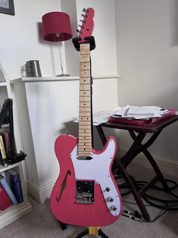

    I've just done a pink milk paint / Danish oil finish - it's nice stuff to work with.
    https://www.thefretboard.co.uk/discussion/277460/first-finish-with-milk-paint-and-danish-oil#latest
    Thanks Mark. I’ve studying your photos and threads closely, I’m a big fan and your new build is very cool.
    Do you happen to have any closer up images of this finish? Did you apply it with a brush, and can you see brush marks?
    I have wondered about whether a water based gloss topcoat would play nicely with milk paint and buff to a good shine…

  • markblackmarkblack Frets: 1727
    this help - I can take some more later if you need them.
    I wanted a thin finish so I brushed it on. then sanded it to get rind of any brush marks - I also it thin coats - the say mix the paint 1:1 I did 2:1 with more water. The 3 coats of oil and I buffed it with a polisher. If I wanted a more solid finish I would of done 4 coats of paint. then sanded and oiled. The nice thing is it's no spraying and in the winter months youcan do it at home.
