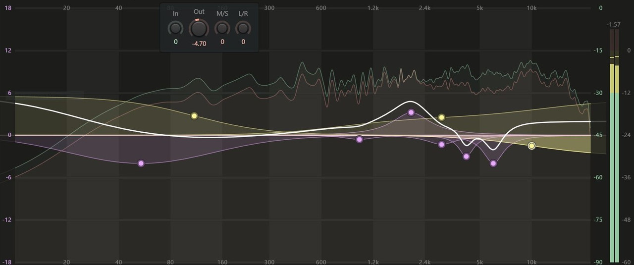

    Here's a quick screenshot that shows my headphone correction filter.
    https://i.postimg.cc/VLvf1Vb7/EQ-Capture.jpg
  • StuckfastStuckfast Frets: 2766
    What headphones are you using that need a 5dB boost at 1.5kHz? I think I'd just get some better headphones tbh.
  • robertyroberty Frets: 12274
    If you can correct, why not. Consumer headphone frequency charts are usually a bin fire, even posh ones

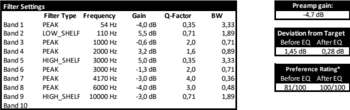

    Sennheiser HD490 Pro with producer pads. Here's the Oratory1990 EQ band settings.
    https://i.postimg.cc/qqycKQq9/Oratory1990-HD490-Pro.jpg
    https://www.dropbox.com/scl/fi/b0sf23etw1pw1wcnr2xdj/Sennheiser-HD490-Pro.pdf?rlkey=x74rntbt2yzvbtv3s7ofn9n0z&e=2&dl=0
    What headphones are you using? The full list can be found below if you want to give it a try.
