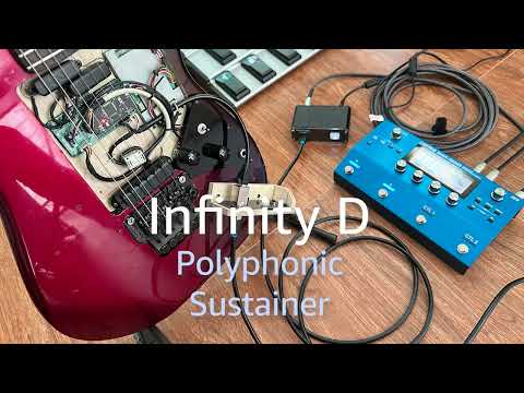

    Joel from Cycfi has been working on pickup modelling.  He gave a demo of some emulated Strat sounds a while ago.
    His software for the virtual pickups is still in development. It can emulate multiple virtual pickups from a single multi-channel input, and move the virtual positions around (even up to the twelfth fret).  He posted a video of an early version which already sounded good, but there's been a long wait because Joel took on so many goals at once.
    He's custom-building a carbon-fiber 'infinity' guitar with an e-whammy bar that can give CV or midi output, per-string (polyphonic) infinite sustain, and multi-channel pickups which are low-impedance with a uniform frequency response.  Also he's built a single-channel pickup with uniform response that can be used in a more conventional guitar with a filter to adjust the tone:
    The big difference from Variax and Fishman's products (and the reason I'm a fan of Cycfi) is that Joel publishes his work open source, including PCB designs.  He explains the technology well in the documentation too.  It looks like his company are keeping their hardware open, modular and reasonably maintainable.  Their aim is for the software to also run inside a pedal, using something like a raspberry pi.
    The electronics in their Thor guitar is also much simpler than a guitar like the Moog E1, where the embedded hardware did a lot of the work that Joel plans to do in software.  The insides of the moog look really hard to service compared to Cycfi's modules, which are all replaceable:
    This is how the current software looks for for Cycfi's virtual pickups:
    I hope some interesting new music will be made using Cycfi's infinity system too.  At the moment I can't find any good demos of the sustain on the Thor guitar MKI, but they say it's been designed to allow subtle polyphonic sustain, so should be quite different from the Sustainiac.
