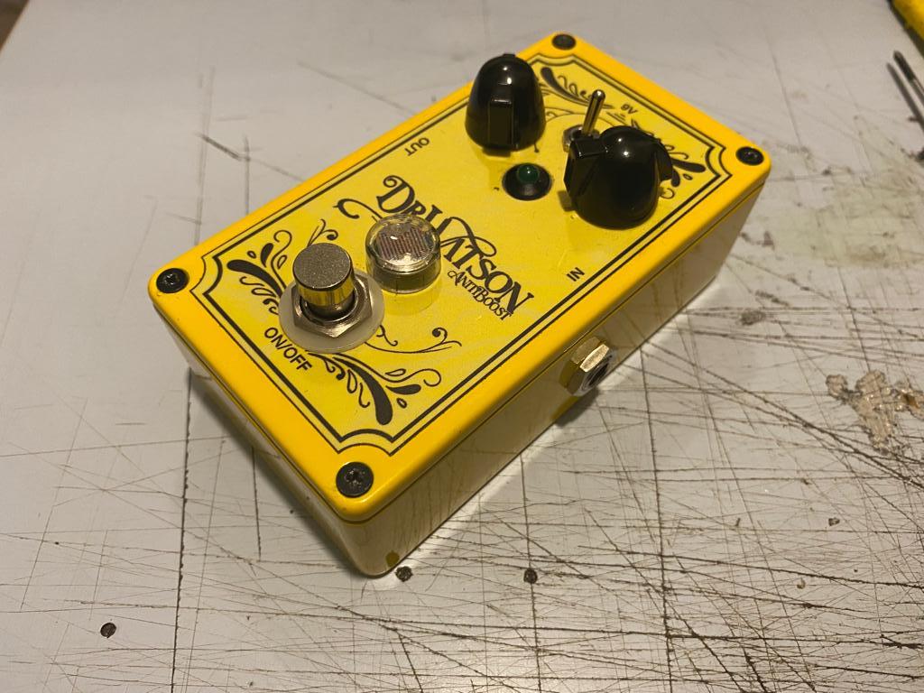

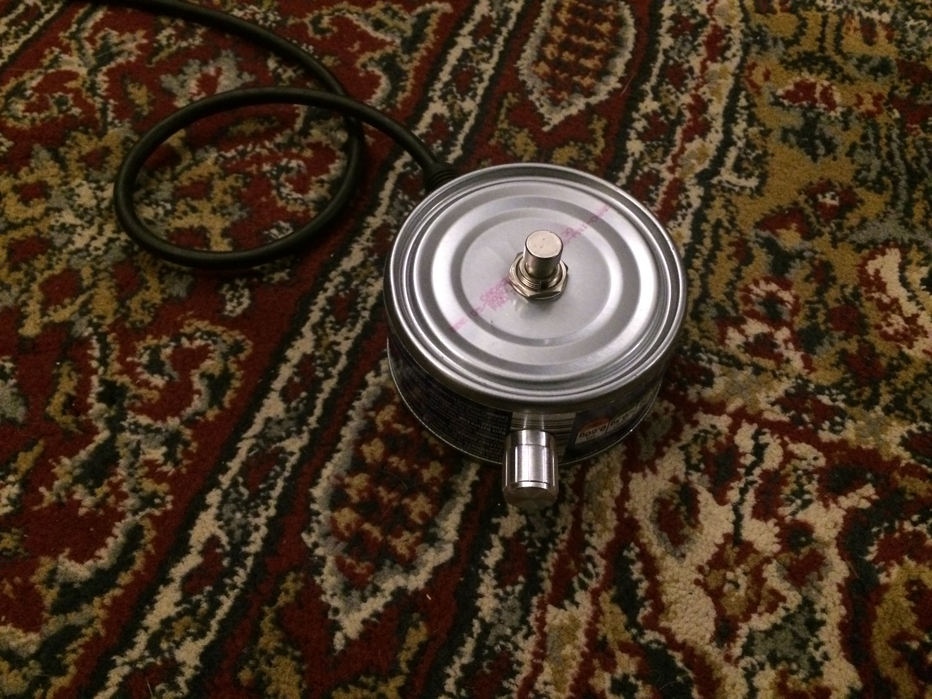

  • Danny1969Danny1969 Frets: 12512
    You can make an antiboost with a can of tuna, a footswitch, a pot and one guitar lead. I did a few gigs with mine before I built a more uniform looking pedal.
    The lead is a bit of mic cable. That can be common earthed the other end and one signal is the send, the other the return.
    Wire the pot the same as you would a single pickup guitar with one volume going to the jack socket
    Wire the footswitch so it's either sending the pot wiper to the output or the end of the pot taper to the output
    Here's a version that expands the idea to 2 volumes, one for normal  and one for boost. I like this as you can then adjust the volume of the non boosted without walking back to the amp.
    Neither pedal needs power unless you want the LED to work.
