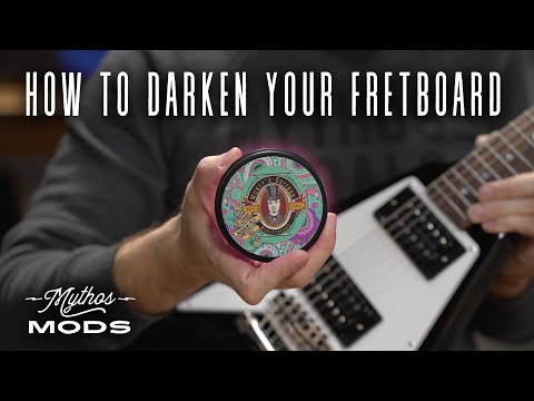

    There won't be any left if this bloke gets it first (skip to 4:45 in the clip).
