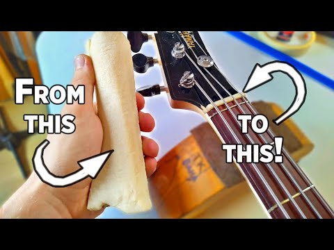

  • WezVWezV Frets: 20220
    make some ;)
    Or you can buy in bulk from aliexpress for very little money.  Even ditching any you are unsure about will get you plenty of decent material to practice with
    the vid is missing a degreasing stage you might need to do if using bone from the butchers.  Ideally you soak in thinners or nathpha for a few weeks first, changing the liquid every few days

    Think I'll pass on that Wez :)
    tbh it isn't as cheap an option as it used to be anyway, not since marrowbones became popular with foodies
