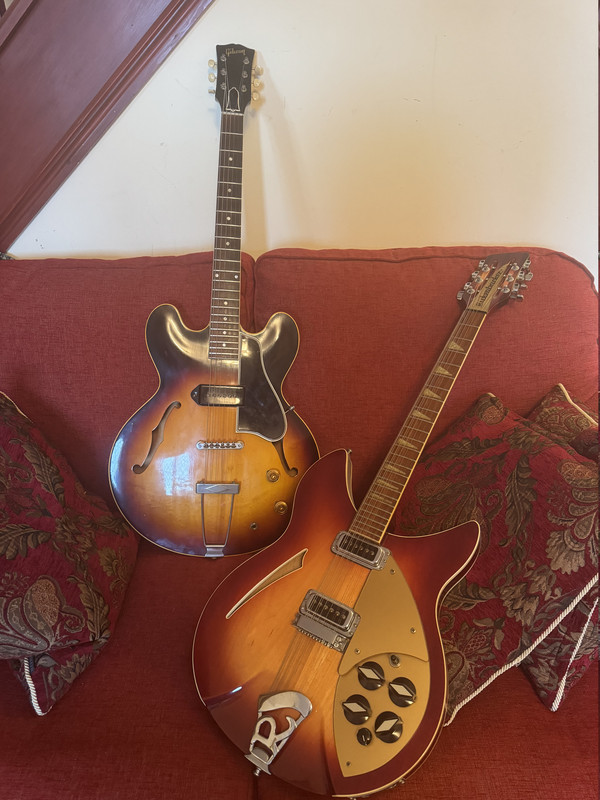

    OK if we’re showing them off, here’s my ‘99 330.
    It’s the perfect Fireglo imho - no yellow/orange tint in the middle and a rich dark colour at the edges. There’s subtle birdseye in the top as well. Pickups read 10.7k/10.5k bridge/neck. It has also has the thickest neck of all the guitars I’ve owned (and measured) at 23.1mm at the first fret and 23.4mm at the 12th. It plays nicely with a low action but found 10s felt very loose, so I recently put on a set of 11s (and it still plays surprisingly easy).
    Spot on Fireglo on yours, very nice guitar sir.
