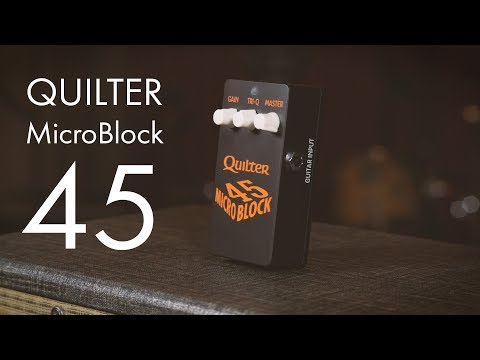

  • I'm a huge Quilter fan, they're probably the market leaders in terms of solid state amps. Their Microblock 45 would be ideal for what you're looking for. Can be neutral if you want, but you also get some EQ shaping and gain tweaking abilities if you need it too:
    https://ebay.us/m/bQIphr
    Thanks DGUYDJ - that looks a definite possible.
