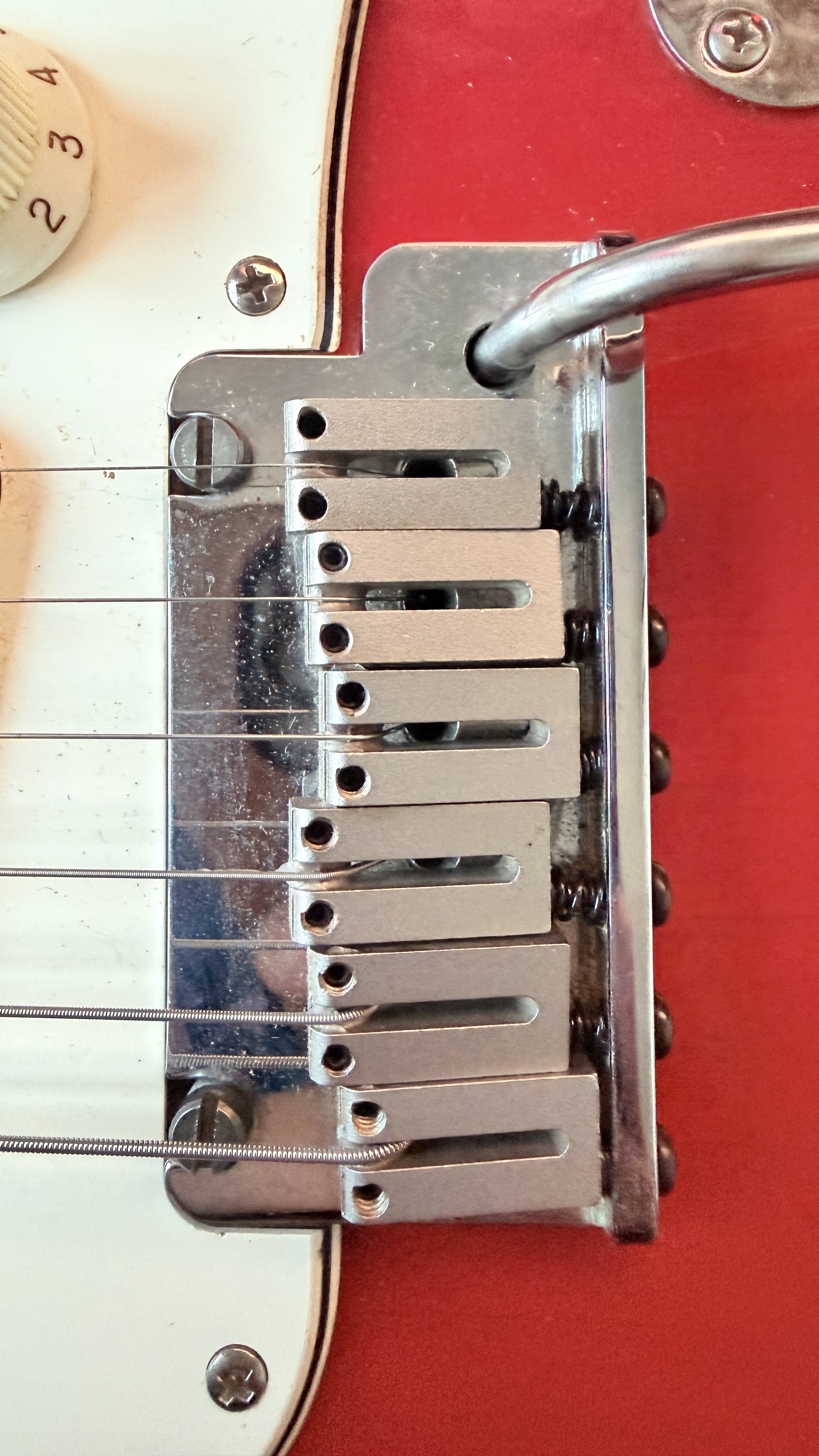

    Thanks all - just tested bending behind the nut, and seems it's the G string. It always ends up sharp when I bend it, whereas other strings are fine. When I use the tremolo, it seems everything is slightly sharp.
    Here are pictures of the bridge and string trees:
    That video is really helpful, thank you - I'll give that a try as well. I ordered some Graph Tech TUSQ saddles as well, so will see if they also make a difference.

    What's that fluff on the string trees?
    I suspect it is some grease/nut lube - It won't do any harm to clean under the G string roller in case of any 'sharp' edges so it stops a smooth travel of the string - To and fro a couple of times with a small round needle file , just to clear any debris

    Yeah, you can see the lube remnants in the nut, string trees and saddles.

    That bridge looks super tight to the scratchplate...any binding?

  • ICBMICBM Frets: 83462
    This - it’s binding against the pickguard. You will need to carefully file back the edge of the guard to leave some clearance. I would remove enough so the gap in front of the bridge is about the same as at the treble side, at least.
