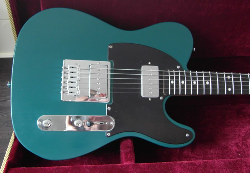

    this was a rosewood board I used feibings on to ebonize it.   I have also done similar on purpleheart with good results
    http://i36.photobucket.com/albums/e31/WezV/complete%20guitars/fin1.jpg
    http://i36.photobucket.com/albums/e31/WezV/complete%20guitars/st2.jpg
    works really well, although you need to give it a good rub down with wie wool to make sure all the excess is gone.  and wear gloves or you fingers will be black for quite a while
    you may eventually get a bit of wear through to the original colour - but it won't be soon, and a bottle will last pretty much forever so its no bother to reapply every few years
