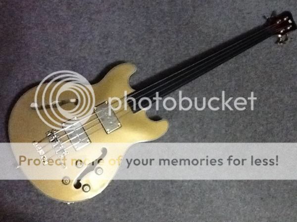

  • martmart Frets: 5205
    ICBM said:
    No thanks :).
    I don't like Warwicks much, and if I get another fretless it will be a semi-acoustic, most likely.
    Good choice. My last (in both senses) was a semi:
