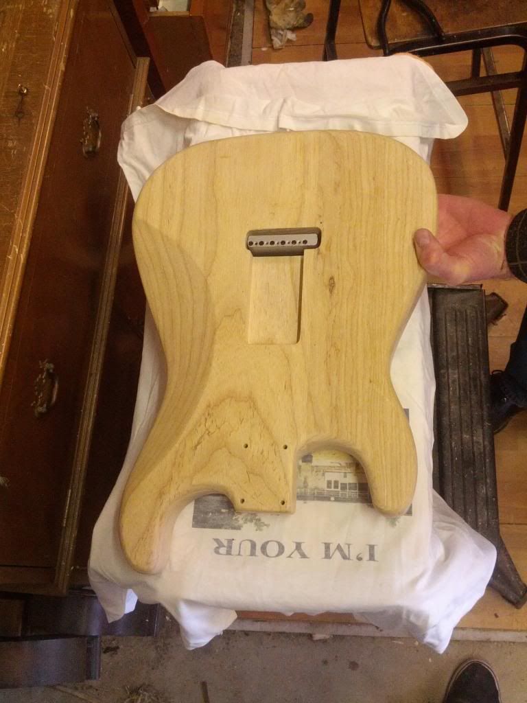

    Heres the back of the body with the bridge block in place (working out where to mount the backplate). Its got a cool bit of spalting on it, shame its going to be covered with a solid colour!

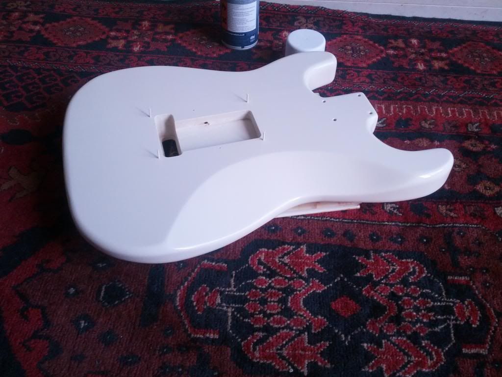

  • Progress!
    I've realised that i'm really lazy at taking photos, so i'm sorry about that.
    The guitar is now nearing completion ;) I polished up the body today (left for 8 days, seems fine), and finished it with a coat of carnauba wax which my dad had lying around for polishing carriage clocks (interesting).
    The finish is okaaaaay. There is quite a lot of grain sinkage which i'm not sure how to feel about, but it looks perfectly smooth in most lights, so it'll do! I think it helps with the vintage look i'm trying to get at.
    Does anyone have experience with freezing the body overnight to try and get subtle crazing? I'm worried it might end up creating some ridiculous cracks, especially given the luck i've had with the finish so far!
    Anyway, here are some cool pics i took earlier:::::::
    This is a makeshift drill extension we made to drill the 6 degree angled claw holes! It's basically a length of brass stock with a hole the size of the drill bit on one end. Wouldn't have been able to make it without a lathe though, which was handy!
    Here it is in action ;)
    Here's where we stand! bridge and neck attached. I've gone for the trem decked with 5 springs, so we'll see how that turns out
    Another extra artistic angle ;)
    Just waiting at the moment on an F-spaced zebra Nailbomb from BKP to arrive to complete the pickguard assembly. I'd previously got a JB designated for it which Van_Hayden kindly gave me some screws for, but i've decided to save it incase i want to stick it into an LP type due to it being more suited to mahogany (apparently)
    Anyway, here we are now!
    Cheers
