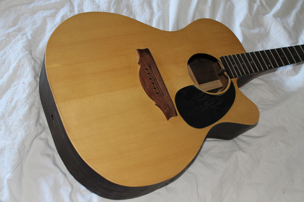

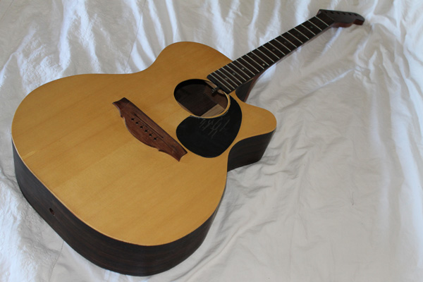

What was:
http://i301.photobucket.com/albums/nn53/parkerska/Washburn D93 LTD into Mandolin/imagejpg1.jpg
Is now:
http://i301.photobucket.com/albums/nn53/parkerska/Washburn D93 LTD into Mandolin/20150821_164019.jpg

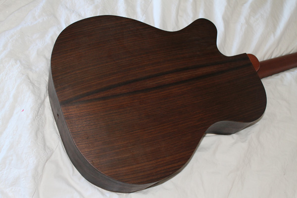

http://i301.photobucket.com/albums/nn53/parkerska/Washburn D93 LTD into Mandolin/20150821_161653.jpg
Back of headstock with new machineheads and odd headstock join.
http://i301.photobucket.com/albums/nn53/parkerska/Washburn D93 LTD into Mandolin/20150821_161646.jpg
Original back used. Added a rosewood heel plate as couldnt save the original maple one.

Too kind AndyJr. I'm overwhelmed that it actually worked! am very tempted to try ukuleles with smaller bodied broken instruments too. Also, for a laminate bodied instrument, it sounds wonderful. Will probably keep it as a prototype, but may sell. If anyone is in or around the South East, Kent and London, come by and check it out.
