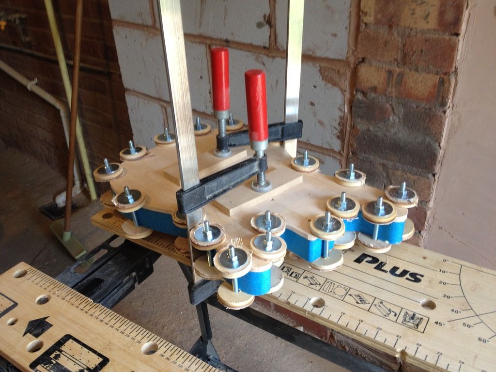

    A little more done today, I've glued the maple top onto the body and it's clamped up for the weekend
    http://i1301.photobucket.com/albums/ag118/wulfhere/FA8492B0-DDBB-45DE-92BF-2743D4EE43E4_zpsgj66vdr4.jpg
    On Monday it will be unclamped and with any luck I can get the router trimmer bit on it and I'll have something very much approaching the body. No belly carve or arm chamfer on this BTW. Planning to bind the top and use a very small rad round over on the bottom (tele-like)

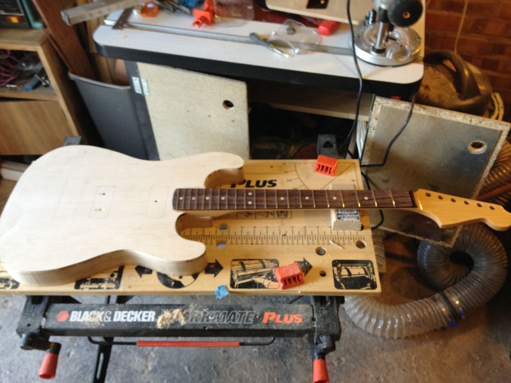

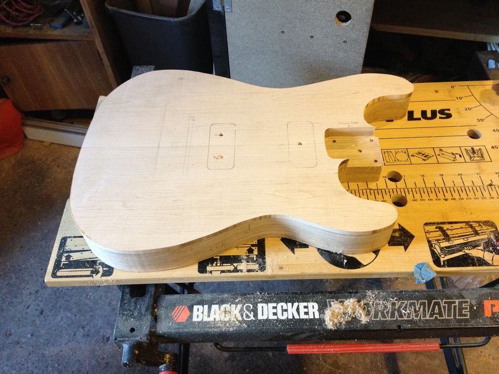

    A decent afternoon's work in the garage, first I unclamped the body and then used a trimmer bit to get the top flush with the body.
    Also routed the neck pocket.
    http://i1301.photobucket.com/albums/ag118/wulfhere/55513B87-BA55-4B94-8167-B39841AAD3D6_zpstzo9xpl5.jpg
    Naturally, I couldn't help but put it together with the neck to see how it's looking :-)
    http://i1301.photobucket.com/albums/ag118/wulfhere/6E2348ED-8E66-4FC0-9495-DACF85B24CAE_zpsaykunztm.jpg
    Still a long way to go, but nice to be able to put the two major parts together!
    I've accidentally routed the neck pocket to 17mm instead of 16 mm - hopefully won't be too bad once I've sanded the top down to make it smooth for painting. Recessing the bridge is always an option if it's a problem.
    Tomorrow will be routing the pickup cavities and then I'll have a think about where I'm going to put my controls and pickup selectors. Have decided to not put f-holes on this one, so there's going to have to be an access panel.

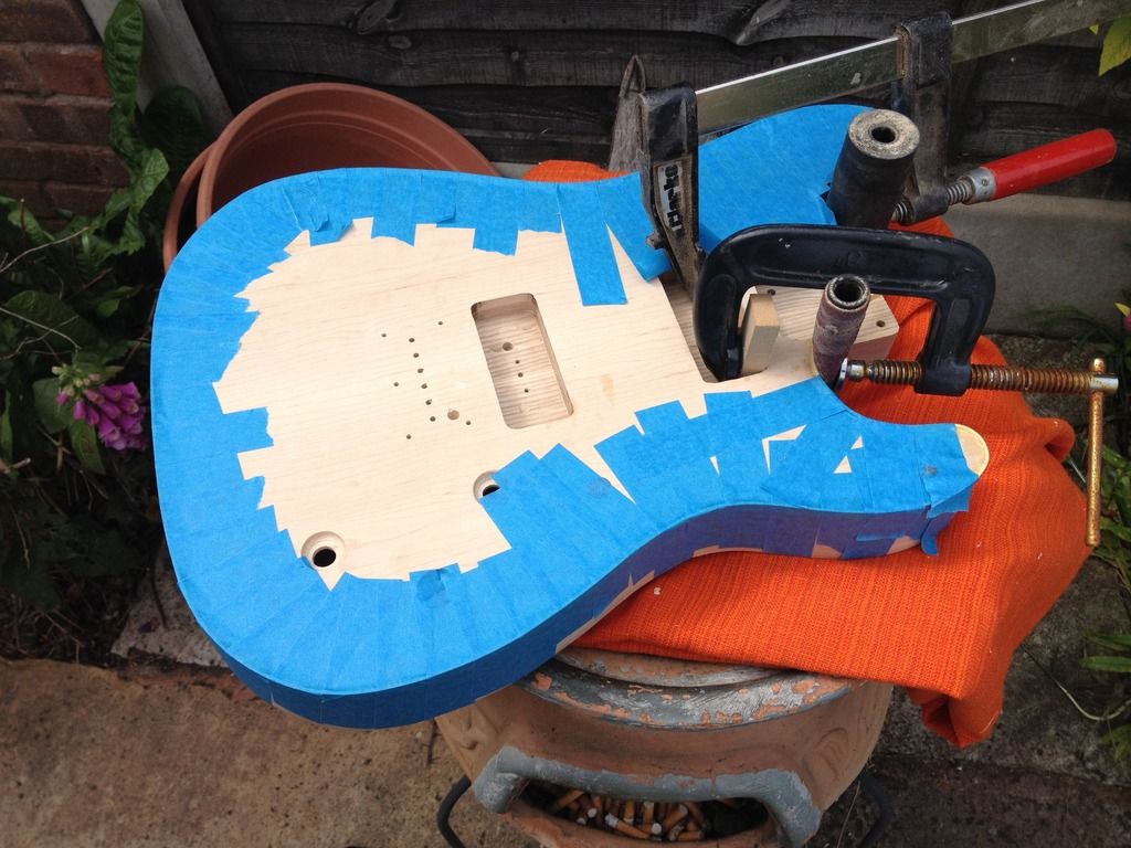

    Here it is all taped up
    http://i1301.photobucket.com/albums/ag118/wulfhere/12BC9FB4-4D54-4B49-8B96-2294F70FB68A_zpsuhwfsbaq.jpg
    and here it is after unwrapping and sanding
    http://i1301.photobucket.com/albums/ag118/wulfhere/62257EB8-8303-4151-8642-FBD94701391C_zpsavkc5nxx.jpg
    You can also see that I've recessed the control knobs. This wasn't part of the plan but is a bit of a goof hider. I fitted the knobs and I actually really like it!

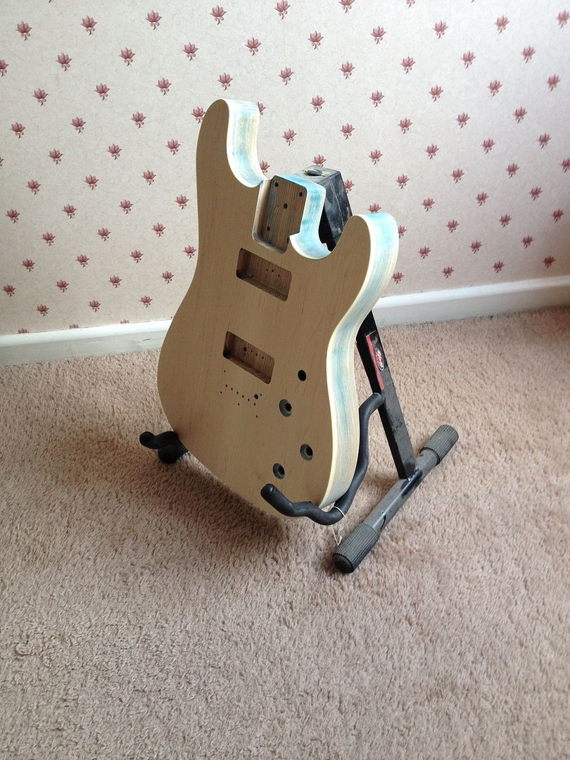

    Okay, things were going well and I gap filled the J-bass with clear gap filler. That went well. I'd got some trans blue for the P90 strat thinking it would make the grain stand out nice. As soon as I put the first bit on I regretted it but there was no turning back. Horrible messy clumpy stuff! I won't be using it again! After a lot of work sanding down today (I gave it overnight to harden), I've got this effect...
    http://i1301.photobucket.com/albums/ag118/wulfhere/F898F336-251A-432E-BBE8-84C7C917AA31_zps2nqlsvvk.jpg
    The finish of going to be a trans blue fading out to black at the edges so I don't think a lot of this will be visible anyway.

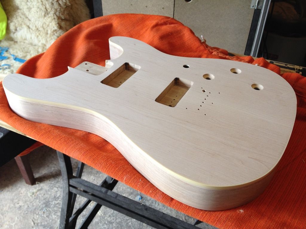

    The body is now sanded down to 400 grit and I think its ready for sanding sealer.

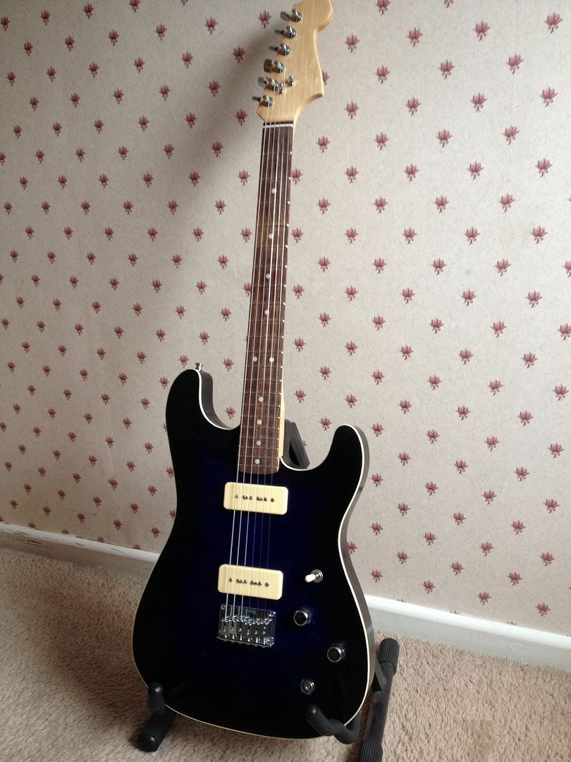

    Right, it's been a while but the P90 Strat is now built. I've not updated in the last few months because I've just had to snatch time when I can get it to work on the guitar and no one particular day seemed to warrant a full update. Here's the money shot:
    http://i1301.photobucket.com/albums/ag118/wulfhere/B9A2B7F5-A081-4B33-8B67-943D4874AC49_zps6ez0hbea.jpg
    The guitar is built, but it's not set-up properly, Mainly because I need to make a nut. The one I've used was one I got off ebay, but its string spacing seems to be slightly narrower than what I was expecting so I'll be cutting my own. Naturally I've had a play of it anyway and I'm really happy with the sound, having never played a guitar with P90s before it was a lot of fun discovering that, while I do have a little of the semi-hollow sound in there I was looking for.
    Happy with the feel of the neck, feels like its a little bit of a soft V rather than the D shape I was going for (at least when played back to back with my Marr Jag), but I get a along with it. Still need to finish scraping the binding too.
