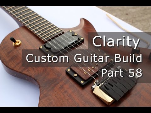

    For fret dressing guides, Ben Crowe at Crimson Guitars is as good a place as any to start with. Episode 58 (and then 59) of his Clarity build...
    In that, he uses a fret levelling file, but he's also done stuff with levelling beams.

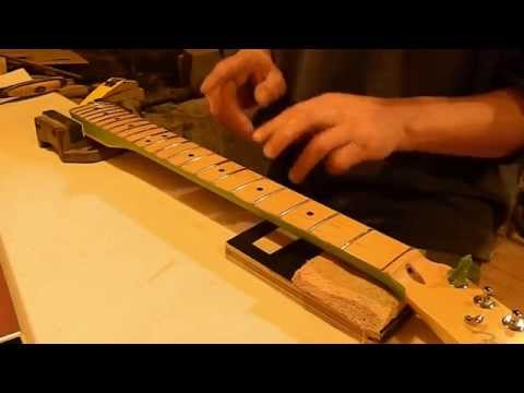

    This two-part tutorial by Duncan Wallace shows the levelling beam in use...

    Just to ask a question here as I am dead lazy on fret setting up etc and normally hand it to someone who knows.
    In the video with the Scottish guy Ducan, he checks the neck without strings with his slotted straight edge says the neck has a back bow without the strings so no opposing tension on the neck. Then adjusts it to straight does the fret dress. When its back at tension will it not be incorrect or he adjusts the truss rod again.
    Is that the correct way to do it
    thanks
    thanks
    PS: T Cut is doing wonders for that finish
    He will likely need to adjust again after
    there are other methods that that let you level under “string tension”, but straightening the neck is a reasonable way to go.
    if using a traditional 1-way truss rod it sometimes makes sense to add a tiny bit of back now before levelling by tightening the rod.  It allows you to add a bit of relief after  when you loosen it.  Normally 1-way rods don’t let you add any relief, you are reliant on string tension to do it.  This is a cheats method to get relief on a vintage style neck that’s too straight.
