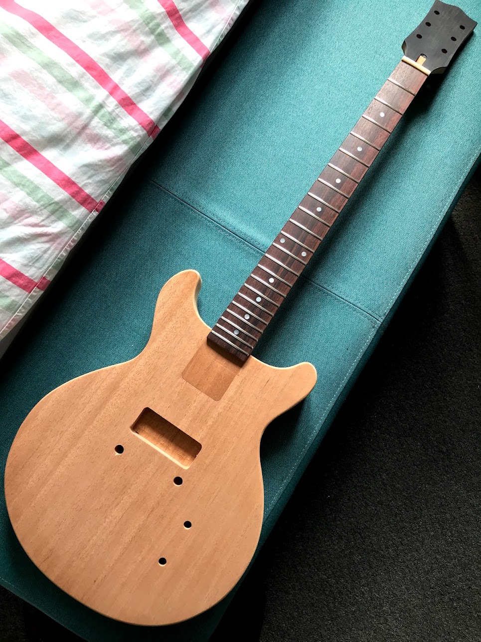

    I'd wager Neil would recommend the Faber vintage style but as I'm lucky enough to already own one of his replicas, I'm going for modern tech with this one.  Bridge post positions are like so... will this work with a Resomax @FelineGuitars? ;
  • FelineGuitarsFelineGuitars Frets: 11636
    without knowing the measurements I'd hate to say completely, and if push came to shove I might dowel the existing holes and go from first principles
