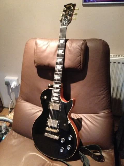

Picked this up in a trade with impmann today:
And now it looks like this...
Need to fit the reflector knobs when they arrive, tinker with the wiring and set up but otherwise it's finished. Overall I'm happy with it but there are a few areas where I could have got the finish better tbh. Not too bad for a first serious attempt though. :)

    What are you planning to do?
  • That looks nice, gold bits apart - seems a shame to abuse it.
    (I've always wanted to say that to someone else ;) )
  • Strip the back and sides which will then be tru oiled. I might keep it as a black top but if it looks like a two piece maple cap I'll be tempted to see what the grain is like underneath. If it stays black I might try exposing a little bit of the cap round the top edge to accentuate the faux binding but that depends on how tricky it is. I'll use the back to try some different techniques.
    The gold hardware will be changed to nickel or chrome, black reflector knobs and I might cut down the pickup switch. A friend did it to his Epi LP and I really like it, doesn't get caught half as much as the full size ones.
    The pickups and electrics will get an overhaul at some point but I'm mainly concentrating on cosmetics first.
    I've only played it through guitar rig so far but it plays and sounds lovely. I don't know if it's the pups or the ebony board but it's got this really punky attack to it that's got me blasting out pretty vacant!
    \m/
  • @jookychap It will be abused with the utmost respect and care! It actually looks nicer in the flesh but it needs some bare wood on it. And probably a Bigsby. :)
    Sounds good to me :)

    Been thinking re swapping the gold hardware, I wonder how easy it would be to try removing the gold plating? I'm assuming it's nickel underneath?
    The only part I'd be concerned about is the tuners due to moving parts, plastic peg heads etc.
     Brasso? Wire wool? Smurf blood?
  • Adam_MDAdam_MD Frets: 3420
    I used brasso on some strat hardware and the nickel underneath had a lovely colour. Looked a little warmer silver than chrome. The brasso cut through really easily but small fiddly bits were a faff and I never did get it all off. If you're going for a worn in look the little bits of gold peeking out from round the tuners made it looked nicely aged. It depends how crisp you want the nickel hardware to be. Either way it'll look pretty cool definitely better than full on gold hardware.
  • The guitar's nearly 20 years old so not looking for a pristine finish and I haven't got bags of money to throw into this so might give it a go. I've read about some chemical solutions which I imagine would be good for parts with hard to reach nooks and crannies but I'm guessing the plastic tuning keys might object!
    I'd rather spend any spare money on new electrics or possibly some new pickups. I think the current ones are 498T/490R going by the dc resistances. I'll wait til I've gigged it a bit but I'm expecting it to struggle with clean sounds. We'll see...

    Had a spare half hour earlier so made a start.
    This is going to take longer than I thought! I used a whole 50ml bottle of acetone on that patch so I'll be ordering a bigger bottle off amazon next week. I think I wasted a fair bit though tbh just getting the knack.
  • LongtallronnieLongtallronnie Frets: 1201
    edited September 2013
    Had more luck today using Bartoline TX10 paint stripper. Looks like a one piece body so far. Unfortunately I've run out of time until next weekend but hopefully have the back and sides done next week. I could do with a full day to get stuck in but that's the joy of parenting for you!
    http://i57.photobucket.com/albums/g232/malarkymusic/IMAG0747.jpg
  • When are you planning to take the covers off? Won't the paint stripper dissolve the plastic?
  • It might do lol, I was a bit eager to get started but will strip all the hardware, covers etc next week.
  • I was going to say that, I assumed Longtallronnie had left them on for some strange reason... acetone will eat those covers for breakfast.
  • I had. I'm strange! :D
  • impmannimpmann Frets: 12668
    Ooooh. No going back now! Good to see some good wood there.
  • Definitely committed now lol! After this week I'm home for a few weeks so hopefully I can get stuck in. Stripping the finish has been harder than I thought but too late to back out now!
