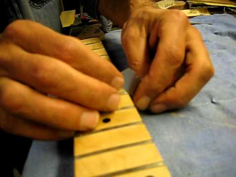

Inspired by things discussed in The Thread That Shall Not Be Named, I got out my abrasives and did this:
I like it. Much nicer neck to hold now, much nicer for thumb-over stuff, just generally obviously basically better. Surprised this isn't more common. :)

    There was a bit of a worry immediately after I tuned it back up - basically that more surface area = more friction when sliding your hand up and down the neck. Either the effect has worn off or I have adapted and ceased to notice, however.

    I roll all the necks of my guitars using the side of a screwdriver method.Subtle but effective.
    Obviously no good on lacquered maple boards.

    actually its the only option on lacquered boards - but it doesn't work well with modern fenders as the lacquer adhesion is poor.  I wouldn't trying it but plenty of people do.   i know this because they tell me I am doing it wrong so every time i post my razor blade method  ;)
    on anything else you can use a blades or abrasives to your hearts content

    I can't see the picture(s) at the moment, but I will when I get home.  Did you just use sandpaper/micromesh or whatever, or were other tools involved?
  • EdGripEdGrip Frets: 736
    Just micromesh. The first 4 grades - none really coarse enough for the job, so it took a while - but on the plus side it made it pretty much impossible to screw up. ;)
    It looks good!
    I like the un-screw-up-ability aspect of using relatively gentle abrasives.  Wez makes the razorblade method look so easy but I'm afraid I'd end up gouging at least a couple of big chunks out of the neck (....or my fingers).
