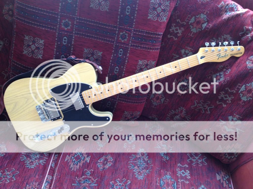

    I built a Tele for my son and one for myself using woodtone and I'm very pleased with the results.
    I haven't taken a pic of mine which is more traditional but below is the first one I built for my son.
