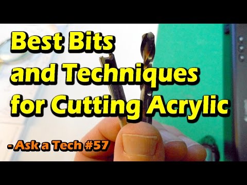

    A couple of loosely related points: it has occured to me that one of my Strats has a transparent backplate on the trem cavity, which I bought from an eBay seller in the Netherlands. Although transparent, it has a very slightly 'milky' appearance, and is not acrylic - probably vinyl? Anyway, I suspect it would be as easy to work as regular pickguard material as it isn't brittle, is flexible etc. It doesn't answer the round over question, but clearly there are alternative materials to acrylic, it's just finding out where to buy them. Also, I recall a blog post on Manchester Guitar Techs website (Steve Robinson, he hangs out in this forum), where he made a transparent pickguard and sprayed the back gold to mimick the Gretsch look. Anyway, he may know where to source materials and may also have some tips on working with them, and his website is also worth a read.
    EDIT: That's a helpful video too.

    In the American video above the tech mentions that cast acrylic is much easier to cut than extruded acrylic but is twice the price. I have found that materials4me.co.uk has 395 x 295 x 3mm clear cast acrylic sheets @ £4.02 each. I might get a couple of sheets to try.
