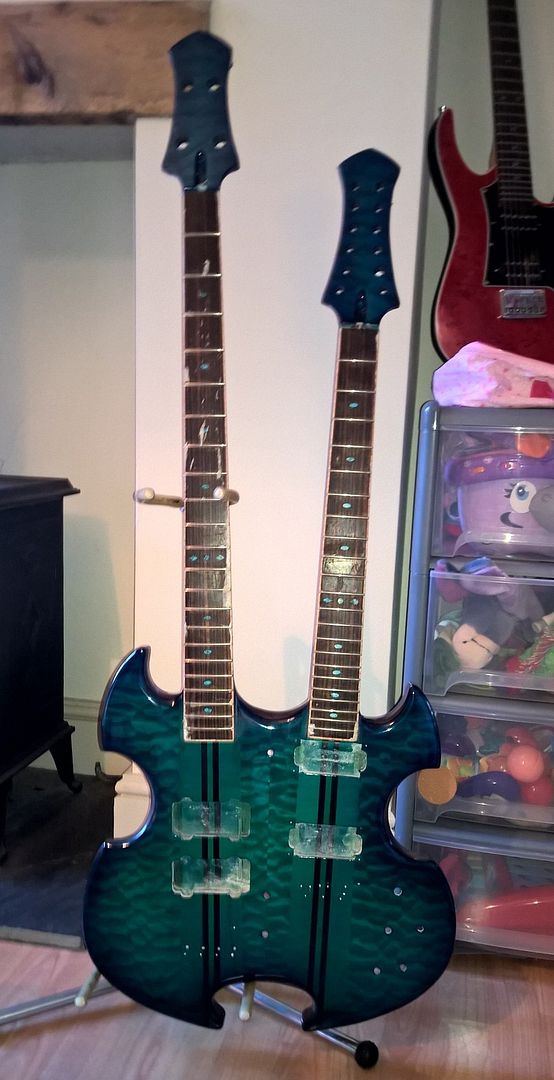

Looks immense!

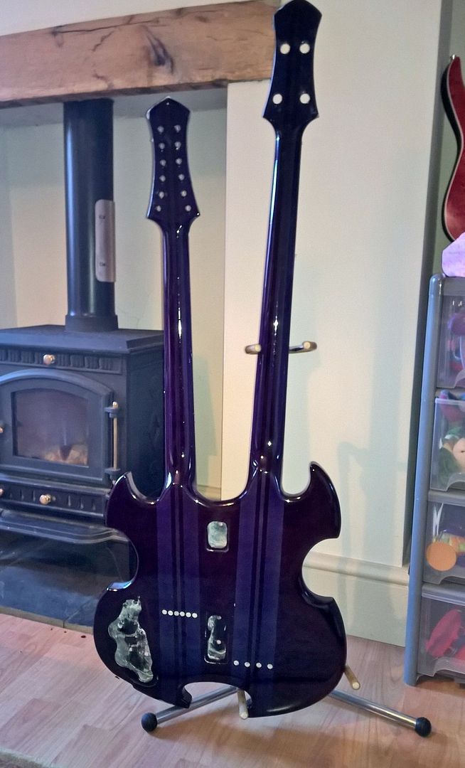

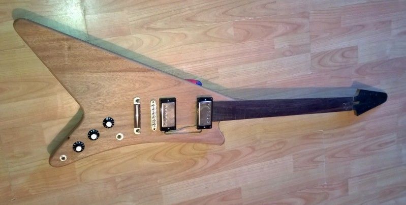

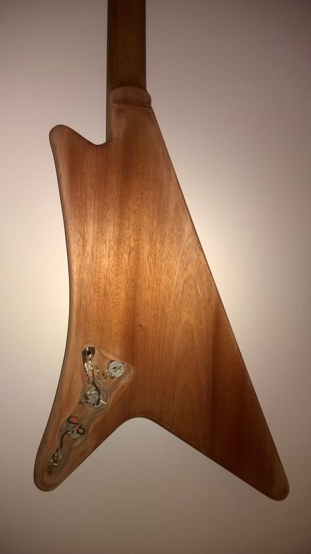

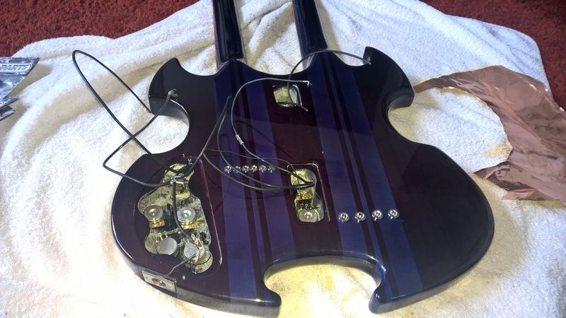

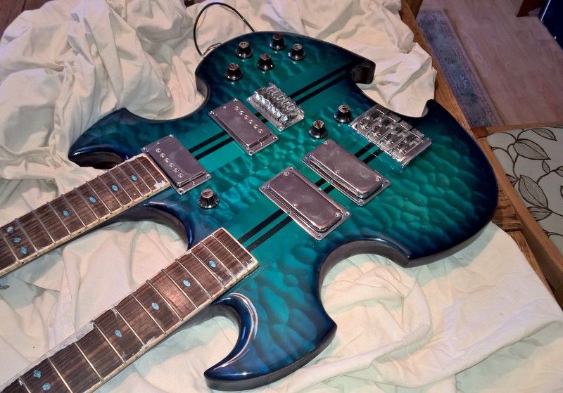

I think it was standard Gibson style wiring on the 12 string and 2 volumes and a tone on the bass.
Then a stereo cable will go to a pedal with on/off footswitches for each neck.
But I need to think about it again

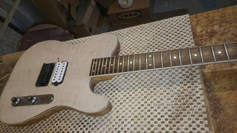

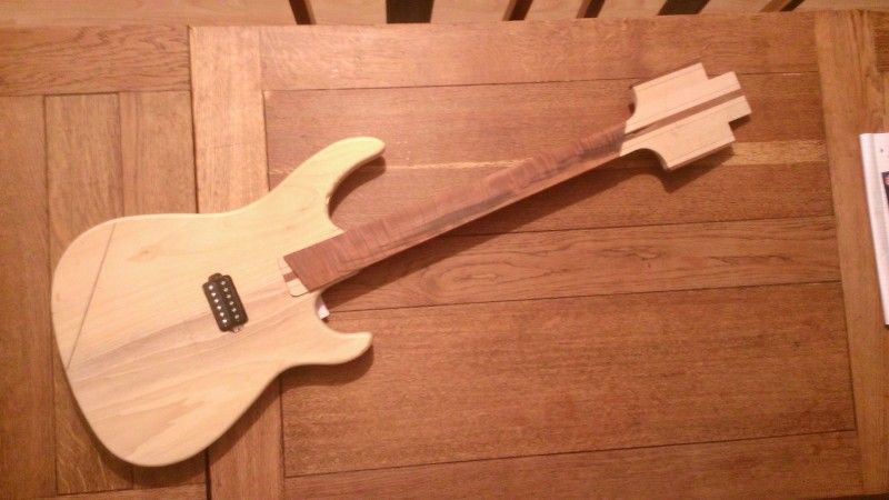

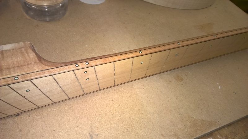

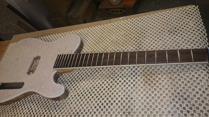

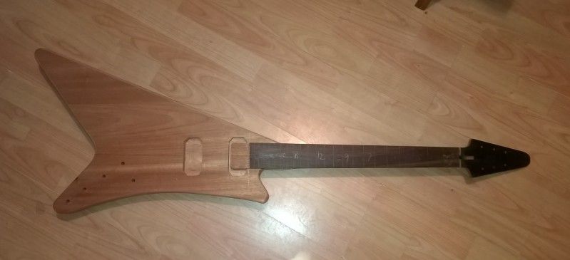

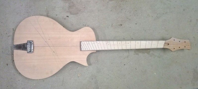

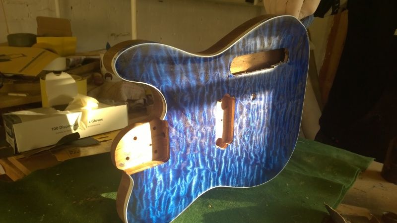

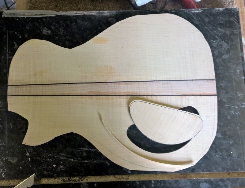

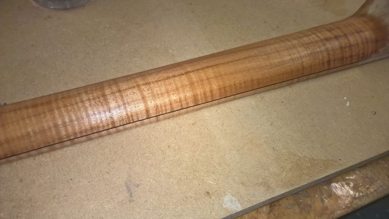

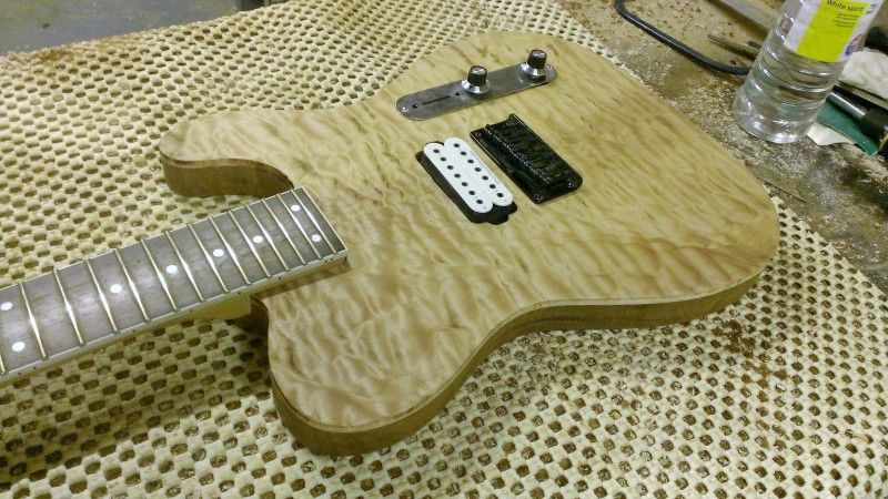

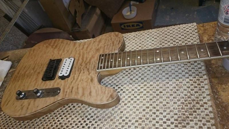

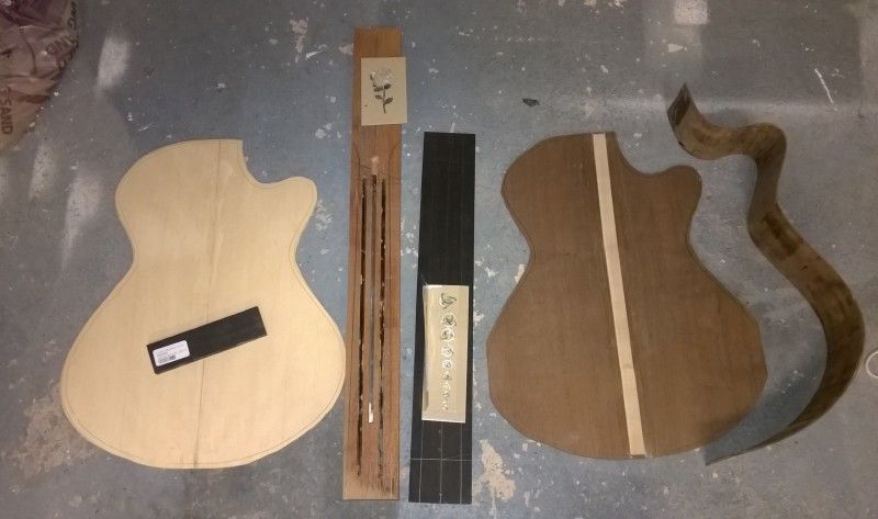

the neck sections go though the thickness planer again after glue up but i dont trust that on shorter planks due to the risk of planer snipe.
the body wood goes through the planer whilst its still in planks form, i its a simple body with no laminates that shouldn't need much else other than a little cleanup before glueing
This was more complex because the wings are 5-layers of wood with very different grains. They all got plained square before being glued together, but they always need a little cleanup after. I am not good enough with a hand or machine planer to get these perfectly square without any risk of tear out, so I used a router and straight edge (usually a psare neck blank thats been through he planer) to trim the glueing surfaces back .
I ten use a sanding board to clean up the last little router or planer marks - the sanding board gets clamped to the bench and I run the body wing on the top
