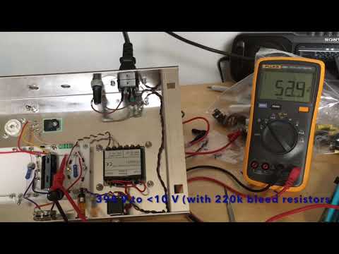

    Here's a little demonstration of how the ~ 400V DC drops down to safe levels in about a minute, as the large power supply capacitors discharge through the bleed resistors that are connected across them.
