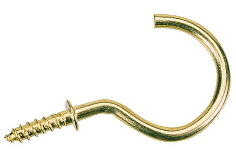

    i put a brass hook in the bottom strap button hole, then I can hold it by the neck whilst I spray the body, and then hang it up to do the neck
  • Thanks Wez. So simple... and that's just me:-)
