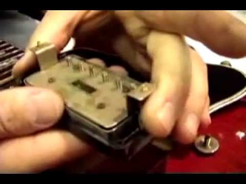

    this old vid from Gibson always makes me smile.  They are recreating Clapton's 335
    18 minutes in - digitally scan the neck
    20 minutes - physically measure everything
    27 minutes in - take a cast of the neck
    30 minutes in - finalize the profile  by feel on a big inaccurate belt sander

    correct vid added ;)
