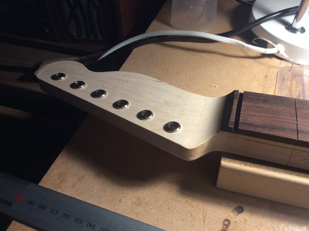

Guys I made a little boo boo on my tele neck today when creating the slope down from the fretboard to the headstock. I oversanded and created a slight depression.
To make it a little less pronounced I’m considering reducing the thickness of the headstock down to about 14.2mm
Would this work ok with my vintage kluson style tuners? The pole piece is approx 25mm tall, so around 11mm sticking out above the face of the headstock. How much further can I sand without running into problems?
I was thinking of sanding the depression out completely and adding veneer to the back to make the thickness back up.
Don't worry about the height of the tuners, the actual geometry from nut to string hole hasn't changed. It will if you veneer the back
Personally I would level it out and add a veneer to the front

14mm overall is fine, I would just do it and not veneer it.
Whilst it is true that the ends of the string posts will appear to protrude slightly further than normal, this cannot possibly look as daft as the modern Kluson brand locking 'heads that I tried on an MIM Classic Stratocaster.
If you actually want to alter the geometry, create a shallow wedge to fit between the headstock and the Kluson back plates.
I have an old Wilkinson USA wedge in aluminium stashed away somewhere. I ought to check the slope angle in degrees.
