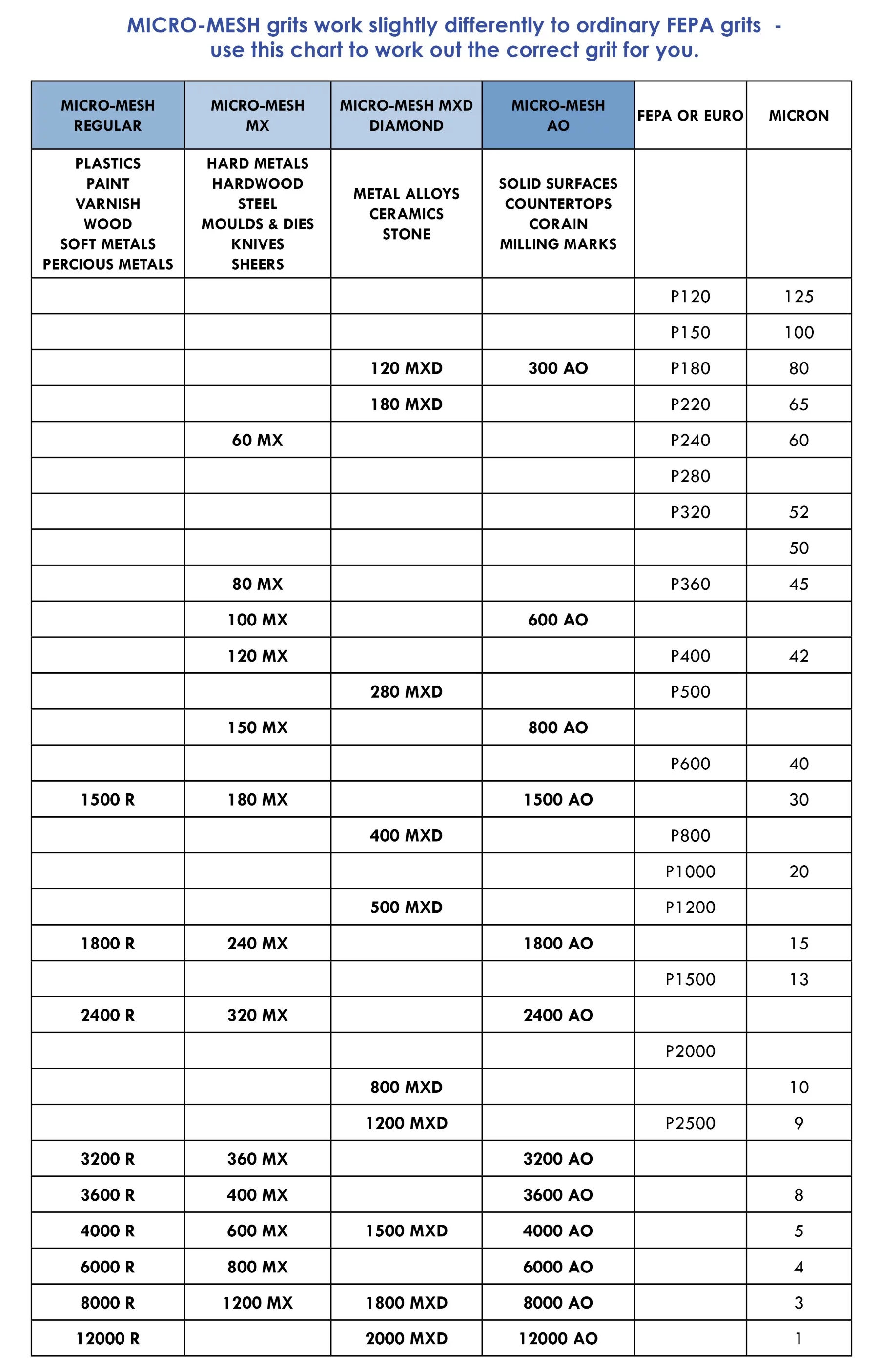

  • With regard to Micromesh an important  point to remember is that their grading system is NOT the 'P' grading system used to describe other abrasives. The Micromesh system is more coarse than 'P' grading. I don't have the specific information to hand, but a P2000 paper abrasive might be equivent to something like 3000 on the Micromesh scale. As I said, I don't have the specific info to hand, but it is something to be aware of, and the information is out there, presumably on the Micromesh website or from suppliers.

  • Yes, I saw that - I'm going to give the compounds recommended above a go from 2000 grit, and see where that lands me. Should be good!
