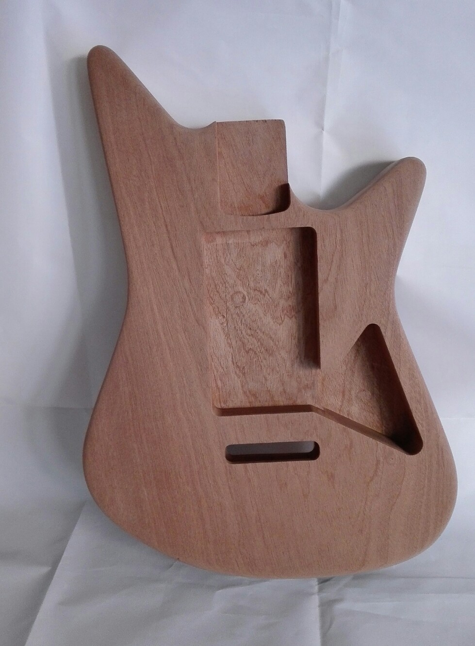

Hi guys and gals. I am building up a collection of parts for the Albert Lee body I picked up, and not sure what trem to get. It doesn't have to look vintage or modern etc. I would rather something that allows the arm to screw in and hold position.
The Wilkinson trems seem to get decent reviews, but not too sure. I would keep an eye out for used as well.
I am not sure I would need to stretch to the price point of a Wudtone for example but don't want to get crap either.
As I have never really had a strat type guitar, I have never really paid any attention to trems and the ins and outs of them.
So for example, what would the main differences be between these examples? Only visual? Or do I need to take spacing etc into account? (Just used Wilkinson as an example here)

    Ah yes, now that I look again at the body I got, it would need the 2 holes drilling, so might look at another option...
    Image 1 - Corpo per chitarra  Albert Lee in Nyangon No forature e Battipenna

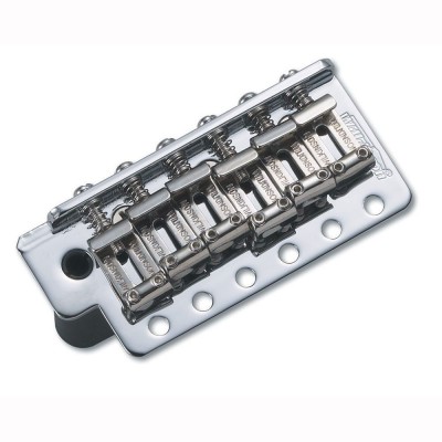

    Avoid any of these with this saddle design.
    WILKINSON WVS50IIK Tremolo Bridge for Stratocaster Strat Classic Knife Edge  2-pt  eBay
     The cap screws which hold the saddles down and the pieces they screw into are prone to failure, they're a pain to adjust (not that much, but worse than the traditional type) and in my opinion they sound thin and warbly.
    The other Wilkinsons which are more like copies of Fender or PRS bridges are OK.

    I agree with this - I really don’t like these ones - not for the reliability issues - but because they impart a metallic zing to the top end that really grates. They also warble in an annoying way that other 2 points like the Mann don’t.
    On the plus side, they are very smooth and I never broke any strings with mine, and the arms are nice and solid.
