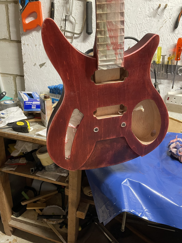

    The wood stain finally arrived and first coat is on
    Sporky: "Drofluf is a reverse vampire, who always appears in mirrors."
  • droflufdrofluf Frets: 4211
    Staining complete and I’ve started oiling. Not exactly how id hoped it would turn out - I should have heeded the warnings on other threads :( but it’s got a well used look to it that I can live with.
  • WezVWezV Frets: 17500
    if you can live with it I think it has an interesting worn vibe to it.  nothing to stop you getting it together now and refinishing further down the line if it starts to bug you
    edited March 2023
    Thanks - funnily enough when I was walking the dog at lunchtime I was drafting the "How do I paint over an oiled finish" post in my head
    Is it even possible?

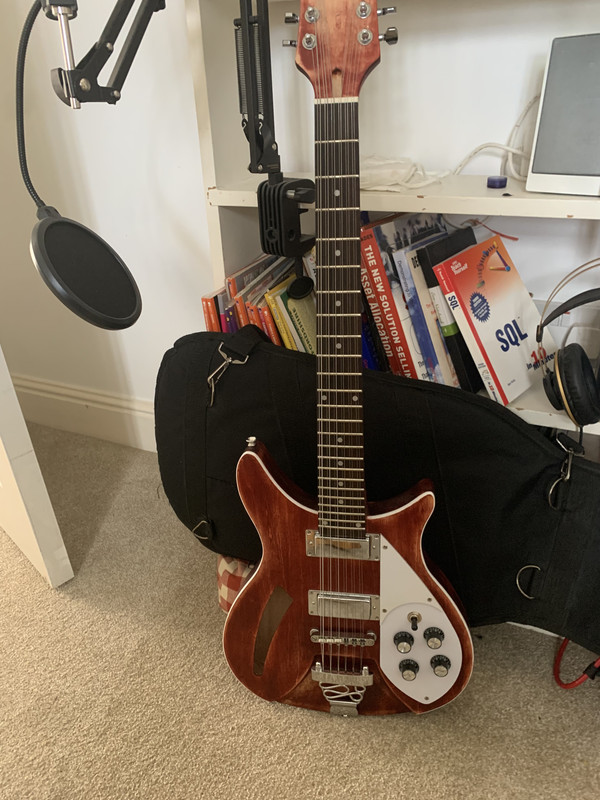

    Well good and bad news.
    The good it’s finished and sounds good:
    The bad; the neck angle is such that action at the 12th fret is about 7mm!  I took it round to a local tech and the plan is to route out a “pocket” to lower the bridge so that it’s playable.
