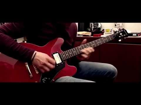

    Made a quick demo of the current pickups. Do you think they sound dark/ wooly?
    This is my first 335 semi so not sure if this design of guitar just naturally sounds a little darker/ wooly than a solid body or if it's the stock pups?
    For those who have changed the stock pups would you say it made a noticeable difference? I'm on the fence about whether to keep it and do the pups and electronics upgrade (making the total spend about £1000) or go all in for a Gibson 335.
    Love the build, feel for the money and would be happy if a pup and electronics upgrade made the difference. If not, I'd probably rather put the money into a Gibson. I know this guitar will never sound exactly like a Gibson but I'd be happy with the Epiphone if it were just a bit clearer with more top end as finish and build feels on par if not better than some Gibson USA's I've played.
    335 into Boss Katana
    Thoughts appreciated

    It sounds fine. One person’s “warm and smooth” is another’s “dark and woolly”.
    In terms of pickup upgrades there are other more affordable options out there other than Monty’s. Fletcher and Catswhiskers both come to mind. Contact them directly, tell them what you are looking for and they will advise accordingly.
    I recently put a Strat pickup (wound with heavy formvar) in HB format into the neck position on a Les Paul belonging to a friend of mine and we both loved the result. It matches perfectly with the PAF style pickup im the bridge, with both producing a lovely jangly chime. Both pickups were made by Q Pickups in Croatia, and again were very affordable.
    Have you tried the Epiphone guitar through any other amplifiers?

    Tbf, your current pickups do not sound bad. But pickup swapping is a bit more than that - new pickups can noticeably alter the feel/response of your guitar and will interact with your amp differently. That's hard to convey with online sound clips, and it can be sometimes a challenge finding those pickups which are an ideal match to a specific guitar.
