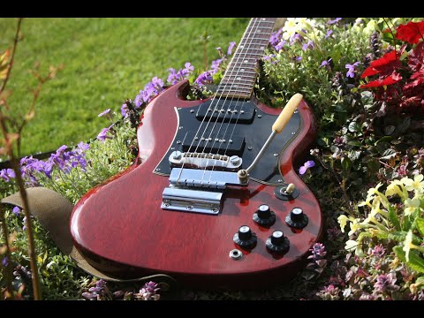

  • lovestrat74lovestrat74 Frets: 2676
    If you are going to install a vibrato system, at least, choose one that works.
    Personally, I would go the HarrySeven route with a Fender Floating tailpiece. (Jazzmaster/Jaguar.)
    Doesn't seem to bother this guy ;)
  • impmannimpmann Frets: 12766
    Thats lovely.
  • longjawlongjaw Frets: 428
    He's only got the top 3 strings going into the vibrato unit (you can see on the photo 1m 17s into the video).
    Great spot @longjaw !!! Maybe that's the way to go with the much maligned vibrola ?
