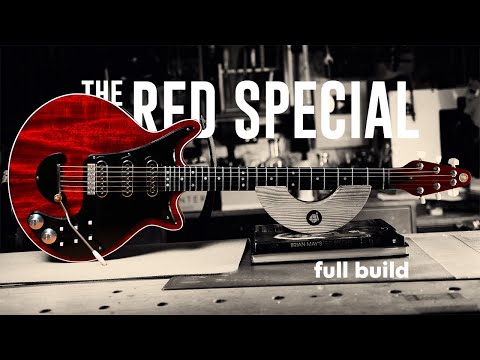

This building of an accurate Brian May Red Special is amazing.
Like, damn! I never realised just how complex the original construction was.
This is pretty mind-blowing.

    I would like to know how old his little girl is, because she did really well with the spokeshave on the neck.
  • GrangousierGrangousier Frets: 2797
    In the blurb he says she's six. I watched it on the TV, so I didn't get to read the blurb until just now - actually looking forward to the voice-over version (and I usually hate voice-overs).

    Fabukous, but I could not understand why the binding all the way round was thin squares of wood rather than a continuos strip - I can imagine all sorts of joints opening up in humidnthen dry conditions ?
  • BillDLBillDL Frets: 9018
    I was a bit puzzled about why he did this also.  I think the squares of wood was so that it was easier to bend the veneer on the curves and secure it firmly in small sections while the glue dried, and also perhaps minimise waste of the sheet of veneer.  Cutting long lengths of veneer and then holding the surface of it firmly against the internal and external curves requires a lot of dexterity and speed as the wood glue soaks into veneer quite quickly and begins to dry.  If you use too much glue it can wet the veneer too much and it will start crinkling.

    All that work hidden in the control cavity!
  • JonathangusJonathangus Frets: 5055
    Half-an-hour very well spent.  Certainly sticks two fingers up at the 'must be a one-piece body' crowd!
    I was wondering that.  Why not just mount the switches on the scratchplate?

    Because then the forces are born by the plastic as opposed to the metal of the cage and that way you don't get cracking and you don't have unsightly screws. It also meant that the switches could be mounted at the optimum height meaning they don't stick out too far. Also the cage provides some interference rejection.
    Check out the real thing, its the same - its a work of art.
    Oh and the real thing is made with *blockboard* to form the wings of the body.
