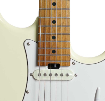

    https://www.guitarguitar.co.uk/product/211119377179025--eastcoast-st2-deluxe-hss-roasted-maple-neck-vintage-white
    I bought one last week and its great, sounds great , plays great, for even more bargains, i'll buy the neck off you for £50  =). (honest I would if you bought one)

    That eastcoast surely won’t have a fender strat neck pocket?

    im pretty sure it does, I measured it the other day, I can double check but its in work and i'm not in til tuesday, i'll whip the neck off and take some pics with my calipers ( i measure the neck width in-situ)
  • spev11spev11 Frets: 333
    and to be fair the neck is a very fine thing, the headstock is a bit marmite but theres no faulting the quality of it (not on the one I have anyway, my mate has ordered the tele shaped one so I'll check that out when It arrives)
    Just did a quick neck width measurement at the 19th and its 56mm. I'll whip the neck off when I;'ve finished my repairs and get some more figures, width, depth and length, anything else? Bolt hole distance?
  • elstoofelstoof Frets: 2498
    Im sure it is but OP already has a Warmoth neck they want to fit so pretty crucial the pocket is fender spec. This fretboard is much more squared off than a strat heel
