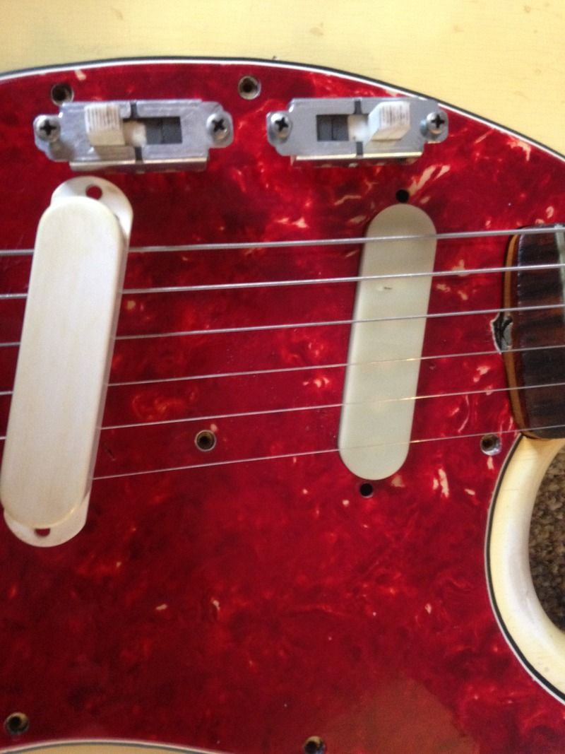

A friend has just picked up a vintage musicmaster and wants to convert it to duo-sonic specs.  this invloves adding a pickup and some slide switches
problem is finding parts - you can find plently of old switches and musicmaster/duo-sonic pickups, but the price is daft and you take a real gamble on quality.   there are some repro parts out there, but again the price makes it a bit daft... So i said I would have a go at doig something
My experience ageing plastics has been a mixed bag.  I have done teas, coffees, stains and shoe polishes and some work on some and not on others. generally, modern plastic just doesn't want to know.  most of the ones that do work clean off a bit too easily for my liking.
But I have something I have used a few times now that seems to work well.... we will get to that in a second

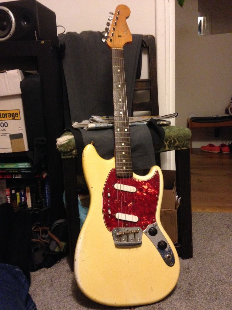

here is the guitar in question
the pickup next to some paper
and a similarly aged Duo-sonic on reverb to show the aim
you can see these covers go a kind of mint green - tan colour.  they are slightly translucent and you can see the poles through them.   that's not something I am going to be able to achieve  without going to extreme lengths (casting slightly translucent covers perhaps) so I am going to do a pair of new aged covers as I will never make a perfect match for the original one

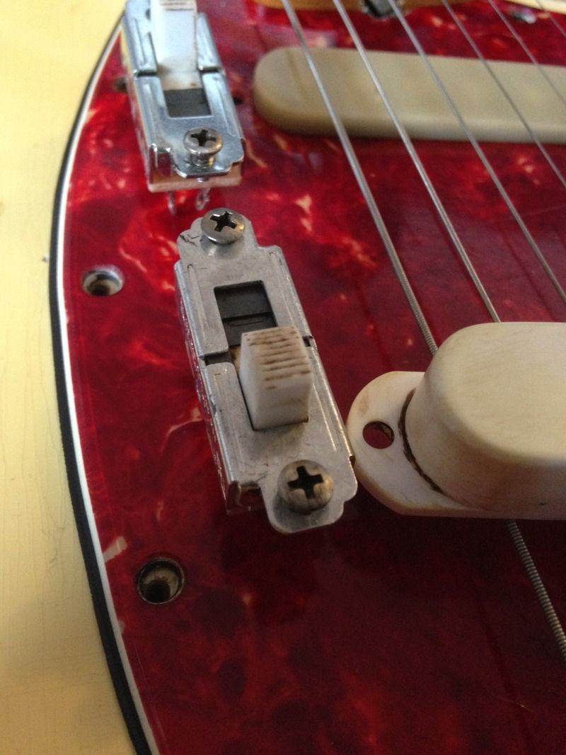

    here is my secret weapon, usually available from your local wilko's or B&Q.  I believe its a shellac and wax mix
    looks messy
    give it 30 minutes and wipe it all off (can leave it on longer if needed)
    and a bit more buffing to even it all out
    thats without any surface prep or anything, although these pickups are not super gloss plastic, if they were i would have needed to key the finish with very fine grit wet& dry first
    now I know its going to work on these plastics I will spend some time softening the edges to get a shrunken plastic look and repeat the process on the parts again.
    I like using this method on switches too because its not going to corrode any contacts, although the screws will get some corrosion too - away from the switch.  they do look a bit disney in the pics above - but that will change once  i have added actual wear  and redone the fake dirt
    this is the hardest wearing fake dirt I have found so far, you will be able to buff it off, but not easily

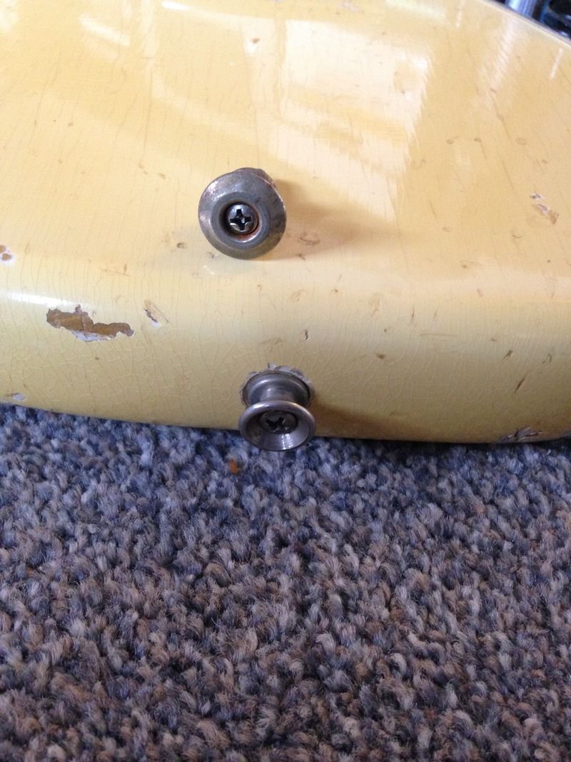

    I had a few small metal parts to age too, not for the vintage fender but I am testing a new technique for the screws for its switches
    these parts are going on my copper stratele.  Normally I use ferric chloride to age nickel, but I had none in.   I do however have two bottles of ageing solution that go with the copper and bronze paints, so as a test the parts go into the acid
    the jack socket was scuffed with 400g first, the rest are went in as is
    about 10 mins later

    today i softened the edges of all the plastic parts before doing another go with the gunk
  • WezVWezV Frets: 16776
    edited March 2015
    So i decided to do a bit more buffing on the aged pickups to lighten them a bit.  the good thing about this fake dirt is its pretty resilient, so even though i buffed it with a drop of fine buffing compound on a micro fibre cloth it has not destroyed the ageing.   A lot of other fake dirt recipes wipe off far too easily
    here we have the original cover, finished light relic and heavy relic version
    which then became two finished light relic covers
